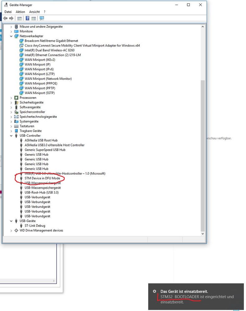

That is anoying. STM32CubeProgrammer does not work in DFU mode and Its probably a driver problem. On Page 7/39 in UM2237 STM32CubeProgrammer software description - DFU Driver. There it is described to uninstall the old 'STM32 DFU Device driver' for DfuSe. Which i Did by deleting the driver in Windows Hardware Manager by right click - deinstall - delete all driver files.
Then as descibed i ran the “STM32 Bootloader.bat� file as admin.
After that reconnected STM32 (any nucleo board) in DFU Mode but still the old 'STM Device in DFU Mode' like in Figure 1 on page 7/39 gots installed and not the STM32_Programmer Driver driver like in Figure 2 page 7/39
Therefore STM32Cube Programmer does not connect to any uController in DFU mode
So how can i make a clean uninstall of your the old DFU driver?
Thaks STM for your help in advance

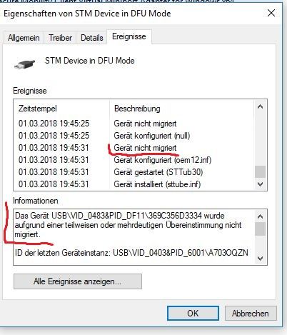

After updating all possible drivers on my laptop still no success.
After deleting driver as mentioned in App Note and klicking the bat file, when new plugged in in DFU Mode Windows 10 installs the drivers as ''STM32 BOOTLOADER'' but list it as old ''STM Device DFU Mode'' in Device Manager
Also when Rightklick in Device Manager on ''STM Device in DFU Mode'' in Properties it says:
The Device ''USB ..... '' was not migrated because of partly or ambivalent  analogy .
lucas239955_stm1
Posted on March 02, 2018 at 04:38
It looks as if the STM32CubeProgrammer was written to look for libusb style drivers.
This is a problem that ST should resolve with an update to the program.
However you are able to get it working pretty easily.
I have found installing libusbk drivers over the windows 10 ones works well.
you can either build your own custom ones, but i have found the program zadig to be useful for this.
You just select the device you want to change the drivers for, select to convert it to using libusbk click a button and then it will all just work with the
STM32CubeProgrammer.
feuerwolf
Senior
Posted on March 02, 2018 at 08:17
You are right, using Zadik is the solution. It took less than five minutes from download to change driver to connect with STM32CubeProgrammer.
Just as you described select the USB device and libusbk to convert and it works.
