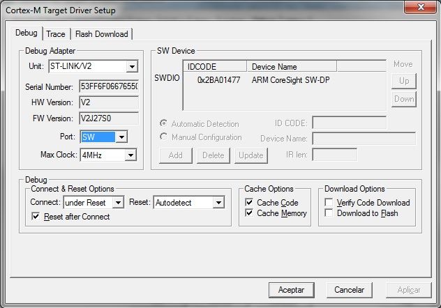

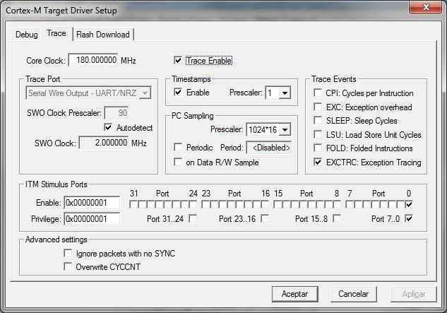

I have a STM32F429I-DISCO and I want print some message with prinf function. I'm following some tutorials but in Debug Viewer nothing is printed.
I get from the STM32F429I-Discovery/Templates/MDK-ARM from the set source STM32Cube_FW_F4 and I put int he main the next code:int
fputc
int
ch,
FILE
*f){
return
ITM_SendChar(ch);

and in the Target options > Debug > Settings is

‎2016-10-07 6:58 AM
Posted on October 07, 2016 at 15:58
Is the solder bridge SB9 made?

‎2016-10-17 11:26 PM
Posted on October 18, 2016 at 08:26
Solved, it was made a bridge in SB9 and it works.
Thank you for your attentionBest regards
