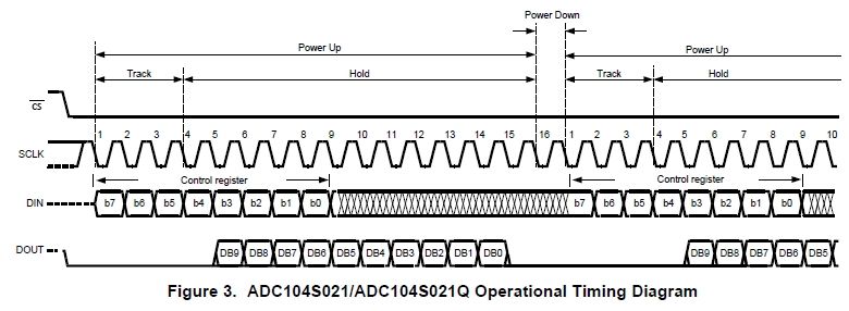

Hi All,
I am developing driver for ADC104S021 for STM32F103
I have tried to read AD converted value from ADC via SPI, the value seemed not correct one.
timing diagram as follows (from datasheet).
my SPI configuration and read function are as follows

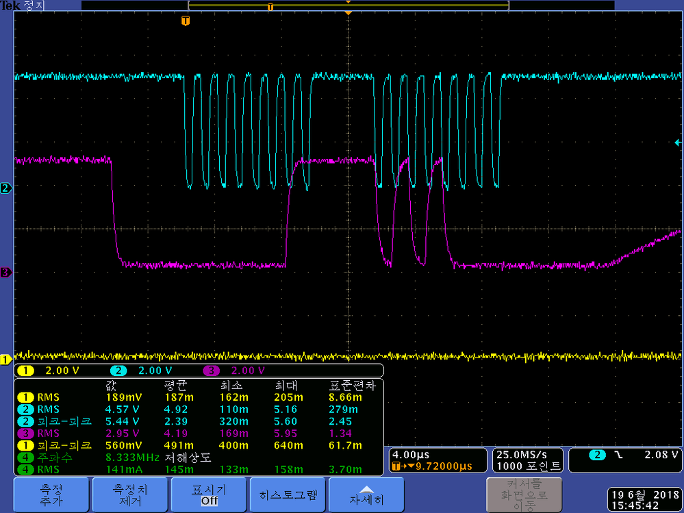

captured data from oscilloscope as follows.
As I read value from capture, it seems to be 0x2, 0x50, but printed log showed it as 0x2, 0xF9.
this is just example, all the values I've got from log are not matched with measured value from scope.
Trying test with multiple ADC values, first byte seems OK, but second byte is totally wrong.
Would you please let me know, what is wrong with my code ?
please help me to debug this, and let me know if you need more info. (FYI, datasheet is attached)

Hae Ryon Jung
Posted on June 25, 2018 at 06:57
Hi All,
Sorry for confusing.
It was caused by capacitor connected with DOUT pin, data is correctly received after removing capacitor.
