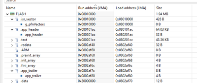

When i debug the application the code is running but the ISR are not working.
Here there is the memory map
The idea is to have 64kb for the botloader and the rest for the application.
The starting point of the application it  should be at address 0x08010000
as usual in the main function i do this ..
Can you please tell me if you see something strange on the setting of the ISR table ?
Thanks a lot

However i will try to not touch the isr_vector by modfing the starting address in flash i will remove the bootloader_section and maybe it should work ?
Bootlader section is before ISR? do not mix linker sctripts, Now we talking about aplication linker nor bootloader,
Booloader need standard linker stript, as i;m notice earlier
Bootloader always need info about whare aplication is start it is enough, from this info you can to everything, that why booloader need standard linker script, (or only for claryfication aplication memory region).
You need to STOP with this approach of attempting to advance the current address pointer.
. = _bl_fw_start + _APP_START_OFFSET;
You're fighting the linker, use distinct MEMORY regions to partition/sub-divide memory visible to the linker. The memory visible to the LOADER and APP are typically different and distinct. One is not fishing around in the memory of the other, at least from the linkers perspective.
  .isr_vector :
    _app_fw_start = .;
    KEEP(*(.isr_vector)) /* Startup code */
    . = ALIGN(4);
  } >VECTORS
  .app_header :
    KEEP(*(.app_header)) /* Bootloader Header */
    . = ALIGN(4);
  } >HEADER
The WHY you're doing this also needs to be questioned.
You can use POINTERs in the application code to access these areas
The interrupts won't work if you're not constructing the table correctly, or not pointing SCB->VTOR at it properly. Needs to be set in SystemInit() typically.
The MCU starts with the presumption that the table is at ZERO / 0x08000000, the STM32 shadows the ROM/FLASH at zero based on the BOOTx pins.
Your APP code should point SCB->VTOR at 0x08010000 once it starts after the LOADER has transferred control.
A better place to bury pointers and image size are table entries immediately after the Vector table, or within unused vectors.
Configuration data or EEPROM emulation can use 16KB sectors, say 0x08008000 / 0x0800C000
uint32_r *p = (uint32_r *)0x0x8004000; // set a pointer to an address, can be used for structure pointers..
Hi @Radosław and @Tesla DeLorean  I have changed the linker in the following way but still isr routine are not working

Can you help me whta i am doing wrong now ?
Thanks
  .app_header :
    . =  _APP_HEADER_OFFSET;
    . = ALIGN(4);
  } > FLASH
this looks wrong.
did you relocate isr vector in boorloder before you start app?
