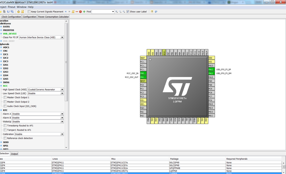

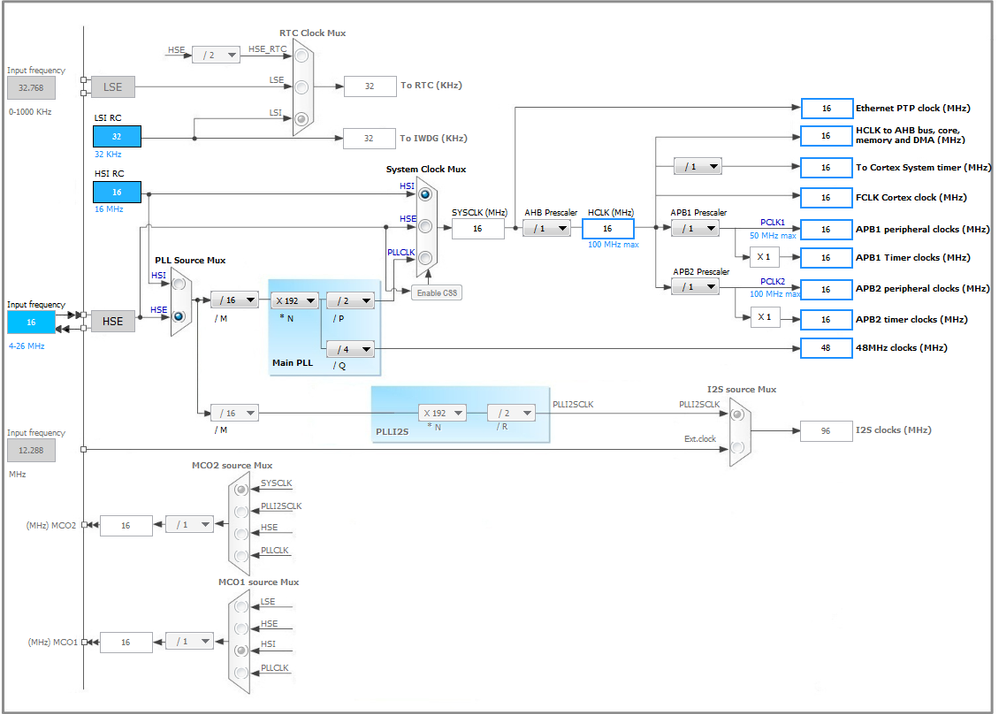

I have a custom board with a stm32f4 I am trying to use cubmx to generate a usb HID project but the generated code does not work. The board appears as an unrecognized device when I attach it to my computer. My board uses a 16 MHz crystal oscillator attached to PHI and PH0. Clock configuration 0690X00000604WWQAY.png Pin configuration 0690X00000604s6QAA.png
I added a call to USBD_HID_SendReport in the while loop of the main function. supporting this was the only change I made to the generated code from cubemx.
Are there any other changes I need to make to the generated code to make this appear as an HID device on my computer?

ruairi
Posted on September 16, 2015 at 00:45
Hi shahrzad
The function MX_USB_DEVICE_Init calls those functions you mentioned; It was generated by cubemx and is called in the main function.
Rosiney Silva
Posted on September 22, 2015 at 18:26
In
his figure
the
''System
Clock
Mux
is set to ''
HSI''
when it should be
PLLCLK''
rlong
Posted on September 23, 2015 at 20:53
 Hi Silvva
I switched the clock source.
Now I am seeing this error message in the device manager which I have not seen before.
This device is disabled because the firmware of the device did not give it the required resources. (Code 29)
