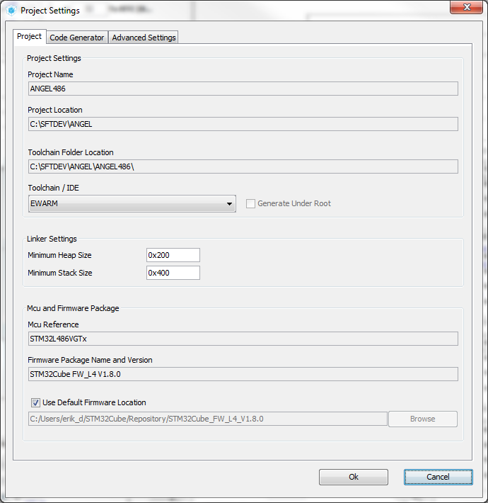

It is 1.8.0.
I must add that I had developed the current code using the previous version, then upgraded the CubeMX version and did a ''Generate Code'' on top of the existing project. If that makes any difference...

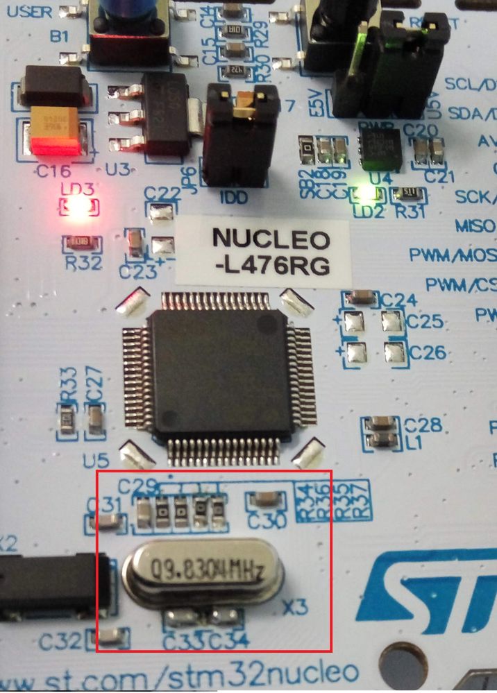

hi, Ed,
I used a STM32 nucleo board with L476 to make a test.
I got no 2MHz crystal, so I choose a rarely seen 9.8304MHz as the HSE clk source.
Everything works fine for me. I mean uart and systick.

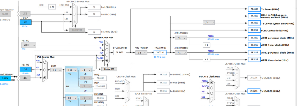

My clk tree
Uart also works.
