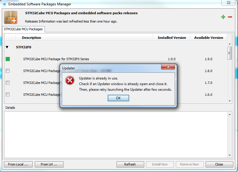

‎2018-05-31 5:40 AM
Hi
Deng.Rock
,This window
brings
out when the updater is checking for update (or working
in
the background
) and you want to change for example the configuration of your proxy. In that case, a pop up window appear. For example, I had
succeeded
to reproduce yo
ur issue
by
:New project CubeMX (load mcu)
Help ----> Manage embedded software packages
Help ----> Updater setting
===> the window appear
Please let me know about the steps you followedto get this issue. I
t will be more helpful if you can send me your log file (C:\Users\xxxxx\.stm32cubemx\STM32CubeMX.log)
Please do not hesitate to contact me for further details.
Best Regards,
Mohamed.

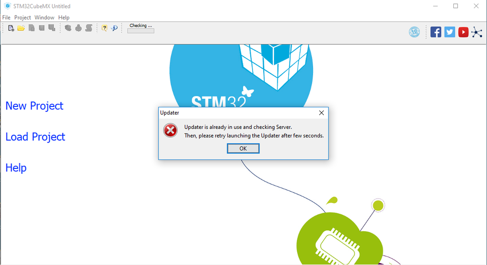

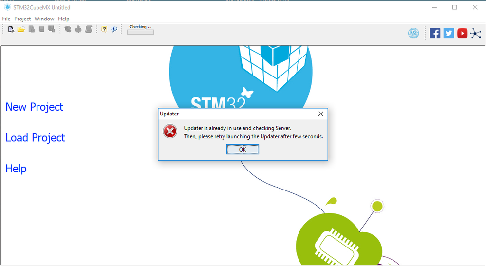

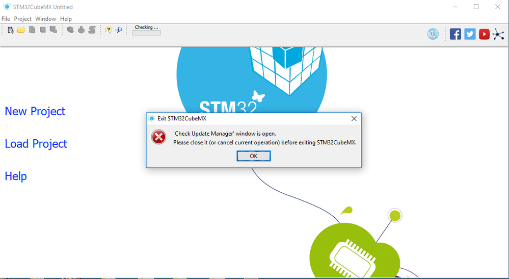

‎2018-06-01 9:31 AM
Hi Mohamed,
Thanks for your answer but sadly it did not solve my problem.
I took some screenshots to show you what is going on.
At start STM32cubeMX software version 4.25.1. It is not possible to disable the automatic update search. When i try to click on ?Updater Settings? appears the message ''updater is already in use and checking server. Then please retry launching the Updater after few seconds''.
This appears when i try to close the software.
This appears when i click on ''new project'' option. This is very strange, because obviously i have a internet connection and i have added an exception in my firewall (just in case).
After i click on ''yes'' appears again the same message.
This situation happens two times and then i have access to this screen, but after 5 minutes it is impossible to work. My pc is absolutely frozen.
