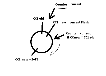

Hello, I want to create flanks with an Timer4 interrupt. I works if i use the interrupts from
 external flanks. Now I want to create the flanks with an internal frequency. Its a little
 complicated to describe all so I only describe the  problem.
Timer 4 CC3 and CC4 are used to create the outputsignal-flanks with an interrupt. For a
 new flank I have to load a new value in the CC3 or CC4. But if i have a frequency wich is
 less than 2^16/72MHz  => 918µs... I need a counter for the overflows. The counter is set
 to with the number of overflows and counts down with ever CC1-flag.
Every time if I load the interrupt CCs i also load the CC1 with the same value. Now I can
 check with the CC1 flag if the timer pass the 918µs after the last flank. But if the
 new CC1 is to close the old CC1 one CC1-flag is left. I tryed to correct this by checking
 the distance beween old CC1 and new CC1 and if the distance is to low (less than
 25000) I add 2^15 to the value of CC1. Oncurrent I decrease the overflowcounter
 because now it has to run on time more. Now it seems that the overflow is one to less if
 the distance is more than 19000. So I get 1 Flag to much. If the distance is more than
 5000 the outputsignal is correct. Is there a better way to do this or what is the bug in the
 program?

Well, I'm confused.
If you want low frequencies, you might want to seriously consider increasing the prescaler, and getting courser granularity. What resolution/granularity do you need for you settings, what range of frequencies are you looking to support?
Are you toggling pins, is this under interrupt? If interrupting, you have to clear the CCx otherwise the routine will just tail-chain back into itself.
If you want a clean, more long term time base, look are the 32-bit core counter in the trace unit, this overflows at ~1 min.
Consider if you can use SysTick to create yourself a 1 ms time base (900 us or whatever),  and use that to program the ''phase'' for the CCR firing.
schulzm-free
Posted on February 16, 2012 at 17:53
Posted on February 16, 2012 at 19:07
You should be able to attach bitmaps like other files, and then check the address in the attachment view, and edit/paste it directly into the post.
Anyway, consider computing the CC placement in units of 13.88 ns (1/72MHz), as a 32-bit or 64-bit variable. Use CC2 to trigger a mid point interrupt (0x8000, 405.11 us), and use the Update interrupt (0x10000, 910.22 us), if the event occurs within the next 910us you set the appropriate CCR values. You do this by decrementing 0x8000 from the time to placement variable at each interrupt, and then check if the value is less than 0x10000. Then offset that value by 0 or 0x8000, modulo 0x10000 depending if you are in the first or second half of the count.
The reason to do it twice per period is that you can then deal with 455 us of latency, and will avoid missing tight placements. ie you are placing the CC some 455-910 us early.

I am not sure that I understand all. I tryed it in this way but it dint worke. I think there is a bug in the if where I add the 0x8000
