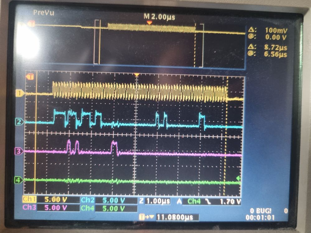

I tried using DMA, but the CS signal delay I'm managing is too long before the start of my frame and ends long after it; I must be at about sixty microseconds, too long.
Note that I'm running my MCU at 24 MHz and I want to be able to retrieve my converted data in about 10 µS.
Currently, I'm using SPI bit bang, or I've configured my SPI port as IO, and I'm retrieving my values ​​in 212 µS, which is too long...

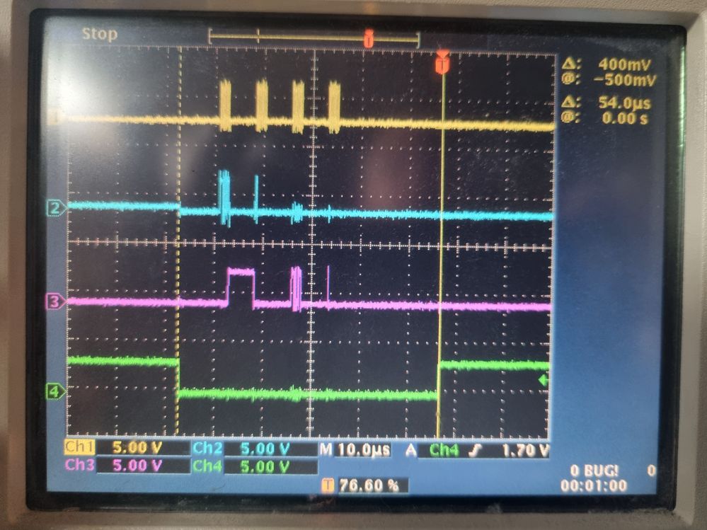

In fact, with bit bang, I get this:
with Hardware SPI, i'm 54us, ...
I'm at a 54us frame rate, much better, but still not there. I configured the STM32CUBEMX to have an spi2 port with the CS (sync) pin as IO, but it takes a long time to respond...
Furthermore, my frames aren't close enough together; I have a latency between them that I can't reduce.
