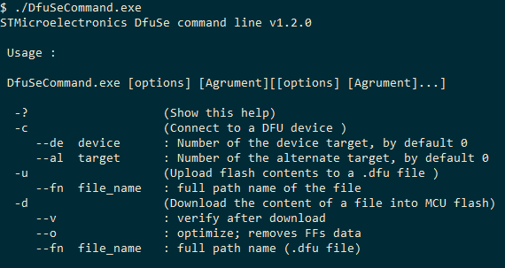

You can use DfuSe command line version as follows:
DfuSeCommand.exe -c -d --fn image.dfu
All options are:

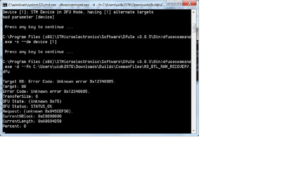

Harsha kadlaskar
Posted on March 21, 2018 at 11:19
Hi David,
Thank you for quick reply..
But i have already tried with commands which are generating errors like below:
Posted on March 21, 2018 at 11:31
Posted on March 21, 2018 at 11:32
where should the image.dfu file should be stored ,because i have save it in another directory D:\ and calling from there.
Its popping like File does not exist.

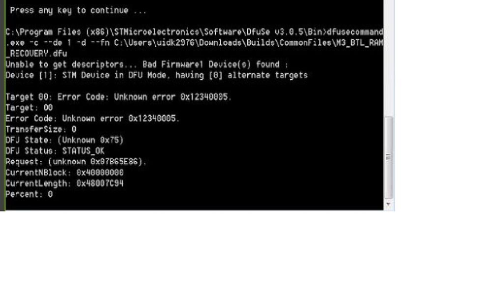

Posted on March 21, 2018 at 12:34
It seems like you provided the wrong device target.
Try using  --de 0 instead of --de 1:
