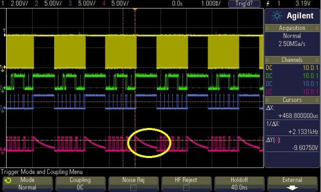

tecnico23
Posted on April 16, 2012 at 11:41
No news.
With SWD I have the same issue.
But somthing isn't ok with the JTDO signal.
Yellow - JTCK signal;
Green - JTDI signal,
Blue - JTMS signal;
RED - JTDO signall.
Regards,
A.Paiva

Posted on April 16, 2012 at 18:15
I can't explain the sagging TDO signal, and I don't think it's a ground plane problem. Most likely external circuitry.
What kind of parts do you have attached to TDO? All you might need is a 47K pull-up

tecnico23
Posted on April 16, 2012 at 18:56
From startup I put a 10K pull up resistor for the JTRST, JTDI, JTMS and JTDO signals. And and 10K pull-down resistor on the JTCK, but after checking all that there was no bridges, and the target was correctly soldered, I started to remove the external components. And after removing the external components I get the above scope picture. The external components are not required because the target has it internal pull-up/down resistors. I read it somewhere.
tecnico23
Posted on April 17, 2012 at 12:38
As suspected, there was nothing to do with my board and nothing to do with the uC.
It was IDE version compatibility.
Thank you all,
