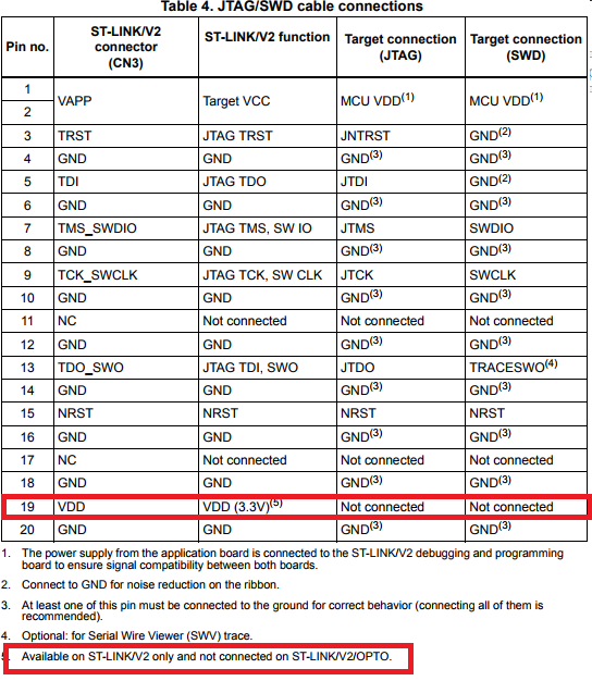

I'm using an STM isolated programmer/debugger.
I'm using it in a serial wire debugger mode (SWD) and connected VDD, GND, SWDIO and SWCLK on my board but can't supply voltage from the programmer itself. The device must be turned on first. Does anyone know if I can supply my board with 3.3v?
I'm using:
Pin1 - VDD
Pin7 - SWDIO
Pin9 - SWCLK
Pin12- GND
Pin15 -nRST
I CAN program but only with external power supplied to board itself.
On the non-isolated programmer, I could jump pin 19 to 1 and get 3.3 v and program just fine through the programmer alone but using the isolated, I can't get 3.3V. I've even probed using a volt meter but can't find how to do it.
Suggestions?

The Pin 19 things isn't part of the standard. Segger uses it to supply 5V
Is there are reason you're using a Isolation pod? Like you need to be physically isolated from the computer side supply.

I would tie the grounds together, remove the 3.3V link from the POD to your board.
power the boards separately, it should come up.
but I would also suggest you stop using the isolated programmer.

I think the pod needs the 3.3V to drive the target side buffers

By the way the Target VCC pin needs to power the target side of inner isolator chips inside st-link/opto,
perhaps some si84xx, as the CO indicated.

Yes we wanted to use an isolated programmer to reduce any change of frying the programmer.
So to confirm. The isolated programmer cannot provide any kind of MCU voltage to the target? The target must already have the voltage and the target provides the voltage to the programmer?

Correct.
It is also good to see you have selected pin 12 for 0V. Don't try to use just pin 4, 6 or 8 for 0V, it will not work as I discovered today.
Posted on January 15, 2018 at 19:41
Yeah I read some other threads saying that ground is only truly on pins 12 and 18. I checked with a probe continuity setting on a meter. Annoying how the documentation claims that any of the grounds would work.
