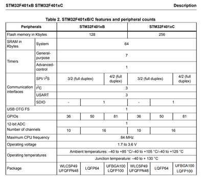

After changing from STM32F401RBT6 to STM32F401RET6, I can no longer put the chip in boot mode. All I did was to replace the chip; my understanding is that both chips are identical except memory. Does it need additional changes?
Thanks for the help!

Both chips have the same boot. Only Flash and RAM sizes are different.
As you replaced the chip check your PCB soldering.

Yeah that is what I have been focusing; I read the AN2606 and everything is identical. Thanks again!
mƎALLEm
Meanwhile you need to check the AN2606 "STM32 microcontroller system memory boot mode"
Sections:
30 STM32F401xB(C) devices
31 STM32F401xD(E) devices
What interface you are using for bootloader?

>  All I did was to replace the chip; ...
What exactly you are talking about ?
Unsoldering the MCU from a board and resoldering a new one ?
Or having different PCBs populated with the RET6 instead of the RBT6 ?
Anyway, have you done something beyond visual inspection, i.e. electrical checks ?
Like comparing current consumption, checking for heated spots, etc.
