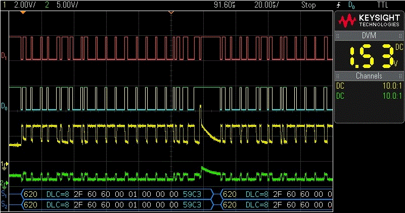

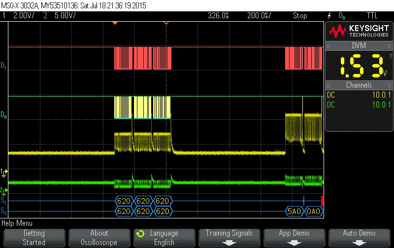

i using stm23f429 as can controller for servo drive
but some time i have over run problem. i check the signals by oscope and understood that , some time fifo of canbx dose not being empty even a can massage transmit correctly and respond is recieved please see attached pic d1-> can_rx d0->can_tx 1->canh 2->canl for example in the pic i need send just one massage to node id 0x620 but i send three massage as the same correctly- Mark as New

Not much information so I'd suggest you look at why the transmitter node is sending three messages back to back. This looks like a software problem. How are you managing the TX mailboxes?
If you are using interrupts the receiver node should not overflow. Jack Peacock- Mark as New

and i have sending over flow problem i just send on packet to node 0x620 by micro controller but three massage has been sent , and after of each sending , node respond EOF correctly so the first packet transmitted true . why micro continues sending?

After a quick look at your code there is a path that will cause it to send multiple times. If there is already a message in the RX FIFO then your loop that does a send-receive will be out of sync, causing a TX message flood.
Make sure the RX FIFO is empty before each CAN transmit. This assumes your other node isn't sending other messages. Jack Peacock- Mark as New
