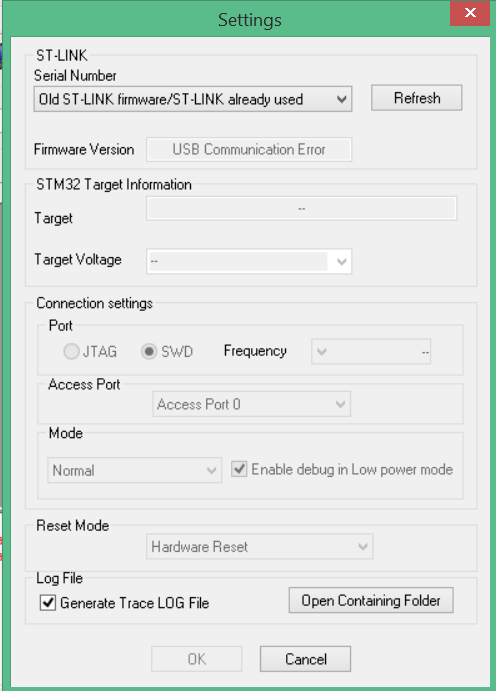

‎2018-01-22 11:43 AM
Just bricked my BluePill board (STM32F103C8) and was not able to connect to it through the ST-Link:
-I got the message ''cannot connect to the target'' in the log window
-ST-Link was stuck with the status ''Old ST-LINK firmware/ST-LINK already used'' (I have the latest firmware on the st-link device so the message was irrelevant)
Nothing helped (connect under reset, low speed, etc), so I re-flashed the board using STMFlashLoader Demo (I pulled the boot0 high to enter DFU mode and start the bootloader - as per your suggestion) and it fixed the issue.
I downloaded the original firmware to the STM32F103C8 (using UART1).
The root cause of the issue (in my case):
I tried to flash the board with the firmware where the SWDIO/SWCLK were disabled. So the solution was about re-flashing the device using bootloader.
Thanks for the suggestion!.
‎2018-01-22 12:09 PM
Entering the bootloader should be sufficient to 'not run your code', and it should be accessible via SWD
‎2018-01-22 12:18 PM
Makes sense. I tried this but I failed. Probably for another reason (the ST-link was still unresponsive).
