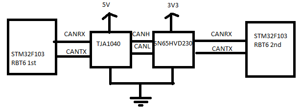

I am using STM32F103RBT6 with Keil C.i try comunication CAN between 2 MCU STM32F103RBT6.
can i do like this image?
Thank you very much.

sure why not? don't forget the termination resistors, your network hould have 60ohm between canh and canl
