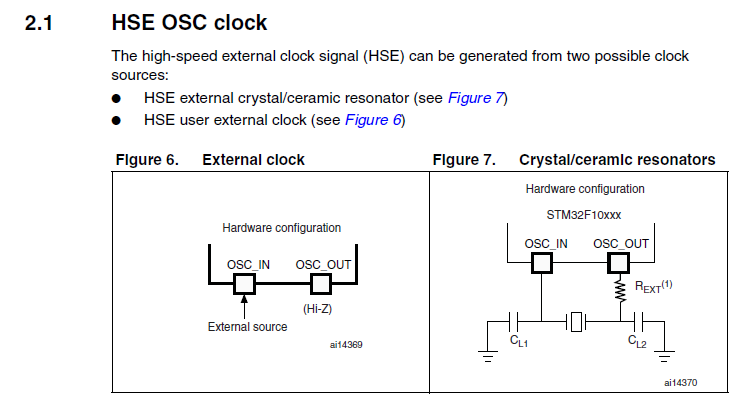

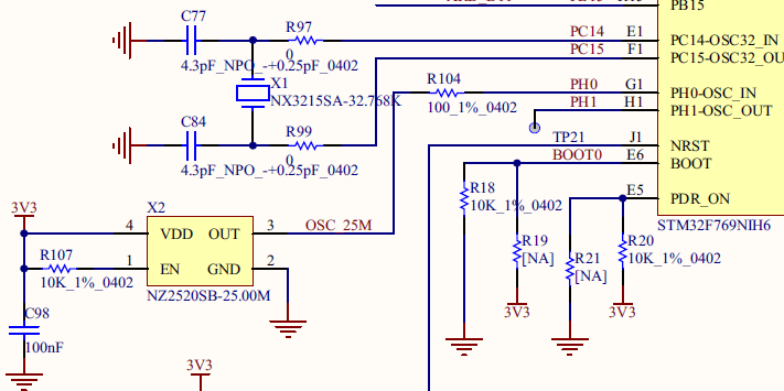

As per STM32F769I-DISCO board schematic, I understood it should be Bypass clock source.
But default cube project gives selection as Crystal ceramic. Why it is ceramic crystal?
Request you to help me which one I should select for STM32 -DISCO board?
TechGuyMike
Since NZ2520SB is not a ''Crystal/Ceramic Resonator'', but rather a crystal oscillator, you should use "BYPASS Clock Source" as the high speed clock option in CubeIDE/CubeMx.

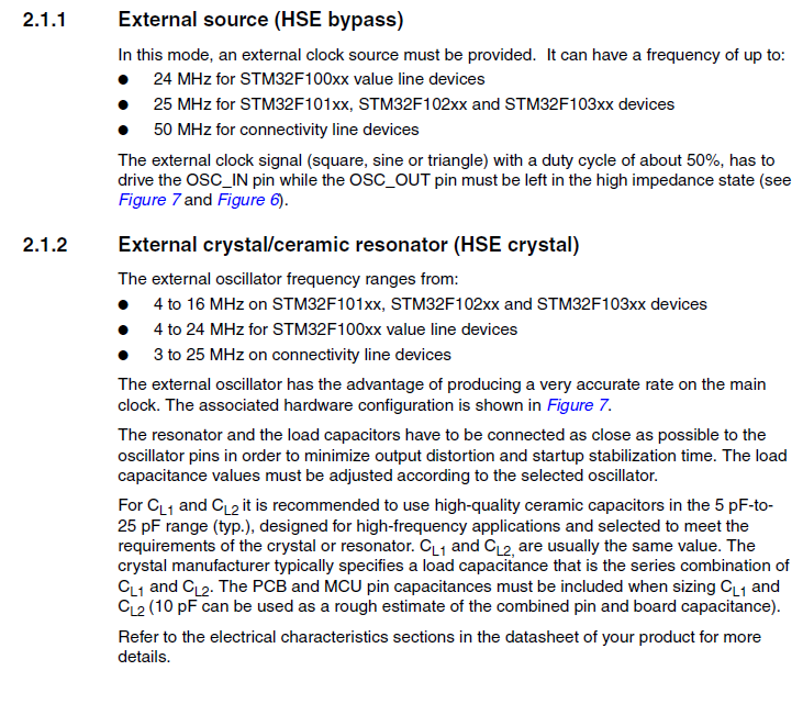

To stop OSC_OUT banging up and down, BYPASS would generally be the desirable choice. The system is going to clock if OSC_IN delivers a pulse train meeting the input requirements.
TechGuyMike
Correct
BYPASS should have different input characteristics, and also not output a signal on OSC-OUT
