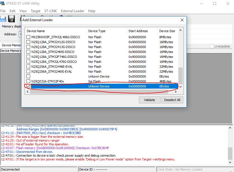

Hi , I have same problem. I am going  to program w25q128FV from ST-Link with custom stm32f746bg board.
I used N25Q256A_STM32L476G-EVAL example in installed ST-Link software. but .stldr file generated with this example does not correctly  identify with ST-Link.
why??
Posted on June 19, 2017 at 13:49
Hi nahvi, at the beginning, I have the same problem
. Then I used the old iar 7.4 to compile the example. The
.stldr file can be identified correctly by ST-Link Utility, but not sure the functions are OK. I implemented a program loader of N25Q064A with custom stm32f746ng board. It can be identified but functions are not working. and I am still struggling with it.
Posted on June 19, 2017 at 14:33
Your options generally are to instrument the code you have implemented so it outputs telemetry/diagnostic info via a USART, or that you test the code prior to integrating it into the loader.
Posted on June 21, 2017 at 16:53
Thank you, I already implemented the qspi serial flash loader, everything works well. So the only issue is ST-Link Utility can NOT recognize the loader generated by new IAR (I tried 7.70.1, and 8.11.2)
Posted on June 21, 2017 at 19:22
Not using IAR, but suspect you'd need to review the .ICF file, the ST-LINK utils have specific requirements in the form/presentation of the object file.
