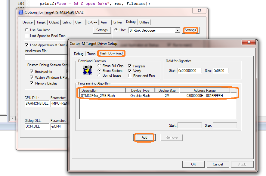

Posted on July 13, 2013 at 02:38
Make sure a) you have the tools set up to ''Load Application at startup'' and ''Update target before Debugging'', and b) that you either use the 2M Flash algorithm or 2x 1M at the two bank addresses.
You can further check that the IROM addresses for the Target are correct (in FLASH), and use the Flash menu to Erase and Program the device.
Are you using an ST-LINK, J-LINK or U-LINK? How are you configuring these, and the flash algorithms?

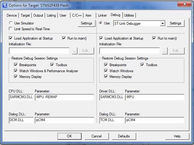

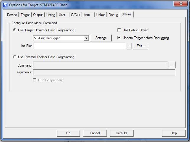

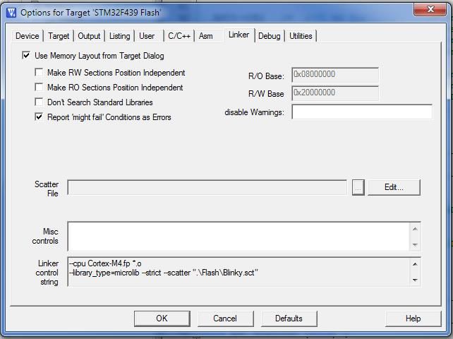

Load ''C:\\Keil\\ARM\\Boards\\ST\\STM324x9I-EVAL\\Blinky\\Flash\\Blinky.axf''
No Algorithm found for: 08000000H - 08000E53H
Erase skipped!
and pop up a windows with
''Error:Flash Download failed - ''Cortex-M4''
I use embedded ST-Link.
Please see the image0690X00000603GVQAY.jpg0690X00000603GQQAY.jpg0690X00000603AYQAY.jpg
Posted on July 15, 2013 at 23:42
tonyyu
Posted on July 16, 2013 at 00:38
many, many thanks.
problem solved.
