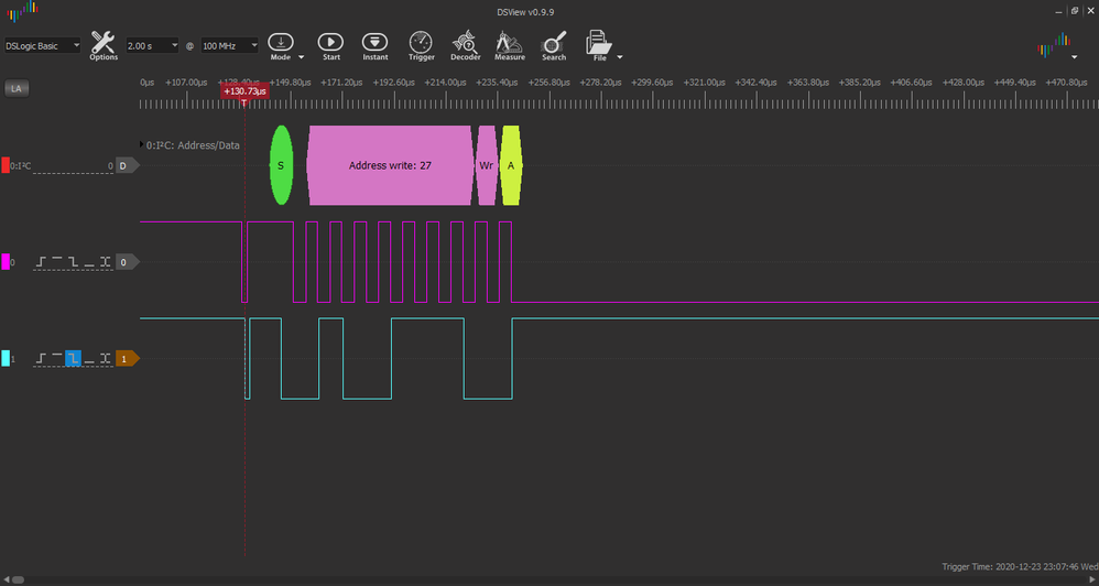

After address acknowledgement, SCL line goes LOW while SDA HIGH with no data transfer in i2c stm32?
Shri
Hi all i dont know what happen to the i2c line just after the address acknowledgement the SCL line goes LOW while SDA high and after that if i am sending data through data register I2C1_DR there is no response.Point to note that that if i initialize the I2C1 two times than again similar output(shown in output.png below) got two time but still no data transfers that means it stuck in data only while for address there is no problem .I check the the frequency of generated wave and it is 100khz which is accepted by our slave PCF8574 .Here I am using IAR EWARM for programming because i want to understand the proper register initialization & for slave PCF8574 GPIO extender..thanks please help

Something is holding down the clock, possible the slave or master.
https://www.i2c-bus.org/i2c-primer/clock-generation-stretching-arbitration/
The little hiccup at your cursor isn't a valid I2C signal. Could be related to that. Can't have SCL go low while SDA is high. You could avoid initializing the pins as AF until the peripheral is active to avoid this.

But why Master/Slave holding down the clock sir...i have two different SLAVES i have tested with both but both of them showing similar behavior..any suggestion sir
Typically one looks at the peripherals with the help of the IDE debugger. The SFRs tab in STM32CubeIDE, for instance.
Like I said in the post, it could be because the I2C signal you're providing is invalid. I'd fix that before anything else.
