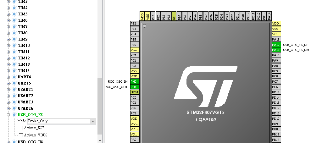

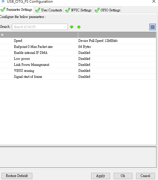

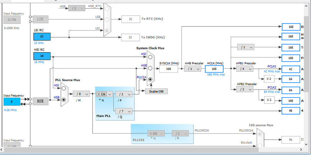

Hi All
    I test the USB Mass Storage in my STM32F4-Discovery when I plug to my PC through MircoUSB connector(CN5). My PC tell me ''USB Mass Storage Device Driver Error'', I don't know what's wrong?  Have any reference method abuot CubeMX?
My Project create by CubeMX. I use the tool to create a Keil 5 project step by step. Condition below:
0690X00000609tKQAQ.png0690X00000609HsQAI.png0690X00000609wSQAQ.png0690X00000609tfQAA.png
