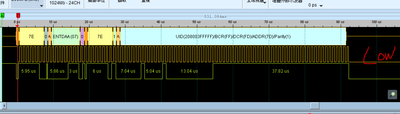

I do the ENTDAA protocol use this code
if (HAL_I3C_Ctrl_DynAddrAssign_IT(&hi3c1, 0) != HAL_OK)
/* Error_Handler() function is called when error occurs. */
Error_Handler();

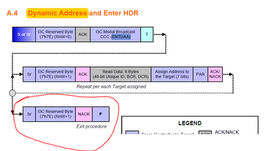

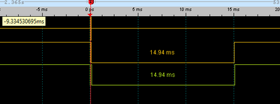

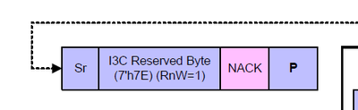

In below picture , I get the ENTDAA Protocol, but After protocol there should be repect start and do End DAA procedure waveform. It always keep  ,pull up high after a few seconds.(ref three pic.
How can I do it?End DAA procedure waveform

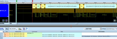

Below picture is all protocol , no End DAA procedure waveform
Hello @CLHUANG ,
You have this waveform because on the IKS01A3 shield you have 2 I3C sensors LSM6DSO and LPS22HH,
So you need to remove jumpers and use one (LSM6DSO for example :  JP2 ) to get the same waveform as the Application Note.
Please check the 9.3 Hardware and software settings section on the AN.

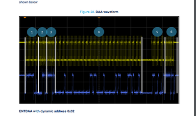

I want same as this sample one => https://www.st.com/resource/en/application_note/an5879-introduction-to-i3c-for-stm32h5-series-mcu-stmicroelectronics.pdf
CLHUANG
I still can't make a protocol with a red circle
