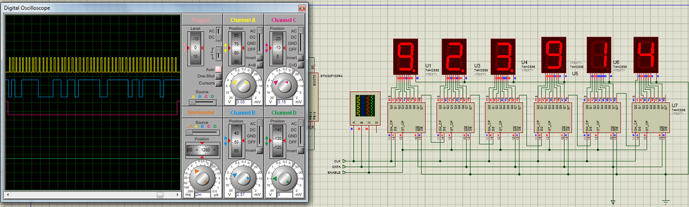

2019-02-27 8:36 AM
Do not use scanning method.
Display with hc595 output.
display doing blink
The display does not remain steady when operating.
I suspect Spi.
I need help
thanks

2019-02-27 11:23 AM
Perhaps you can add some more white space or remove some subroutines?
My guess is it relates to configuring GPIOG clocks and pins, and then using GPIOC

2019-02-28 3:20 AM
You don't include the circuit. My guess would be you are clocking from the buffer shift reg to the output shift reg every clock rather than every 8 clocks.
2019-02-28 4:41 AM
Thank you so much.

while (1) {
// winking here.
delay_ms (100);
segment7 (data);
}I did something like that.
compiler gives warning but compiles.
src \ main.c | 1226 | warning: suggest parentheses around '-' inside '>>' [-Wparentheses] |
it works properly.
but (if) a lot.
