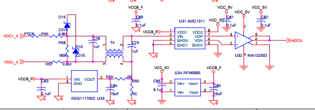

300 LSB error ADc reading in STM32H743BI controller

an I am readin ADC reading 1Msec timer interrupt.

this result Iam getting for 1.382 with reference voltage 2.5 volt.
why I am getting so much of fluctuation in reading.
thanking you.
2 REPLIES 2
Here are tips to improve accuracy:
https://www.st.com/resource/en/application_note/cd00211314-how-to-get-the-best-adc-accuracy-in-stm32-microcontrollers-stmicroelectronics.pdf
The sampling time in particular plays a huge role.
Is this on a custom board or known good hardware? Is the 1.382V signal high impedance?

0693W00000GZ0i2QAD.pngyes, this is a custom board. the signal input we take at point VDC+4 and VDC-4 point, like battery or any source and the ADC4 point connected to controller ADC pin.
thanking you for reply
