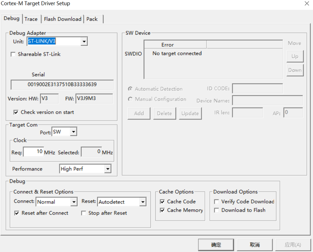

为什么我的程�?烧录一次之�?�就找�?到设备了

"Why can't I find my device after my program is burned once?"
Please refer to this article: How to solve debugger connection issues (st.com), this may help you to solve this problem.
I advise you to upgrade the ST-Link firmware version, then disconnect and connect your board.
Make sure to use the latest release of STM32CubeProgrammer and STM32CubeIDE.

Unclear what STM32 we're talking about, or what board it's on.
Lead with details
Show the working vs non-working situation.
Perhaps pull BOOT0 high so it doesn't run your code.
If this is an H7 part power cycle with BOOT0 High a couple of times and then erase your code.
Check you code sets the power mode LDO/SMPS correctly, check also VOS settings.
Try "Connect Under Reset"
