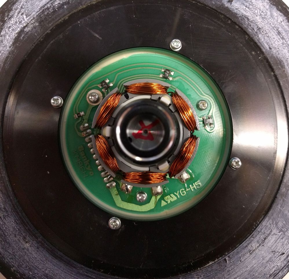

I'm currently evaluating STSPIN32F0 as a solution for BLDC polygon motor control & drive.
My EVB is STEVAL-SPIN3201.
The application is:
  • 38V nominal
  • 8A max @ acceleration
  • 60 deg displaced hall sensors
  • 2 pole pairs

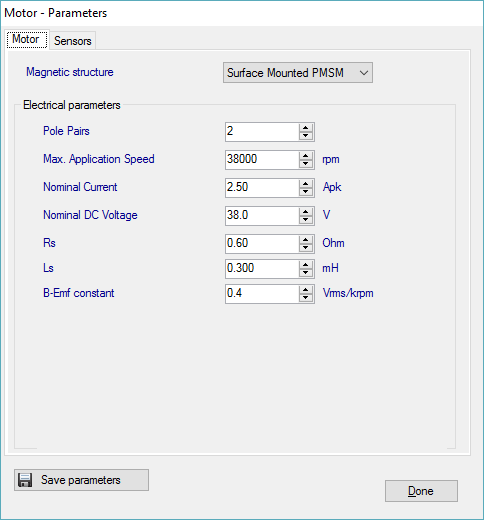

My Motor configuration is

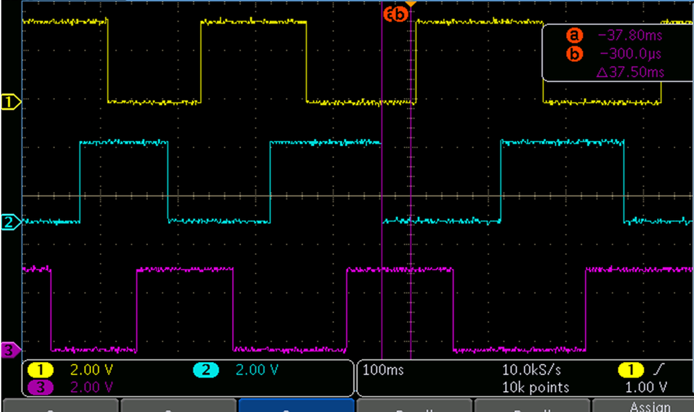

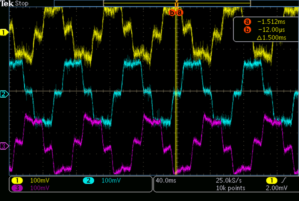

When probing for hall-sensors feedback I get:
Sensors 1-3 correspond to channels 1-3
respectively.

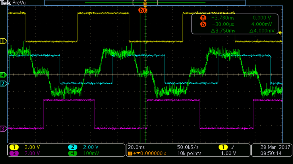

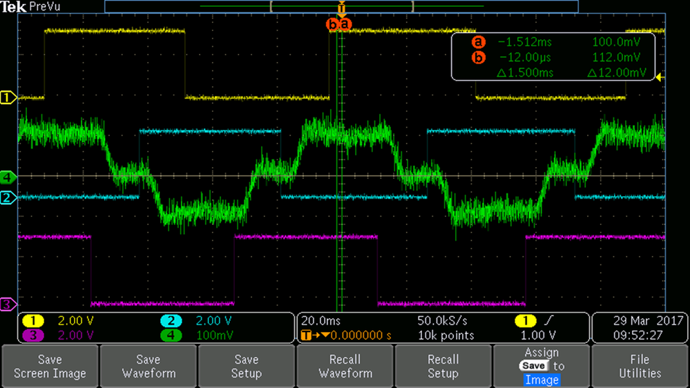

b-emf was also measured:

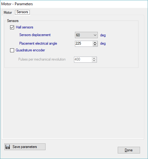

My sensor configuration is

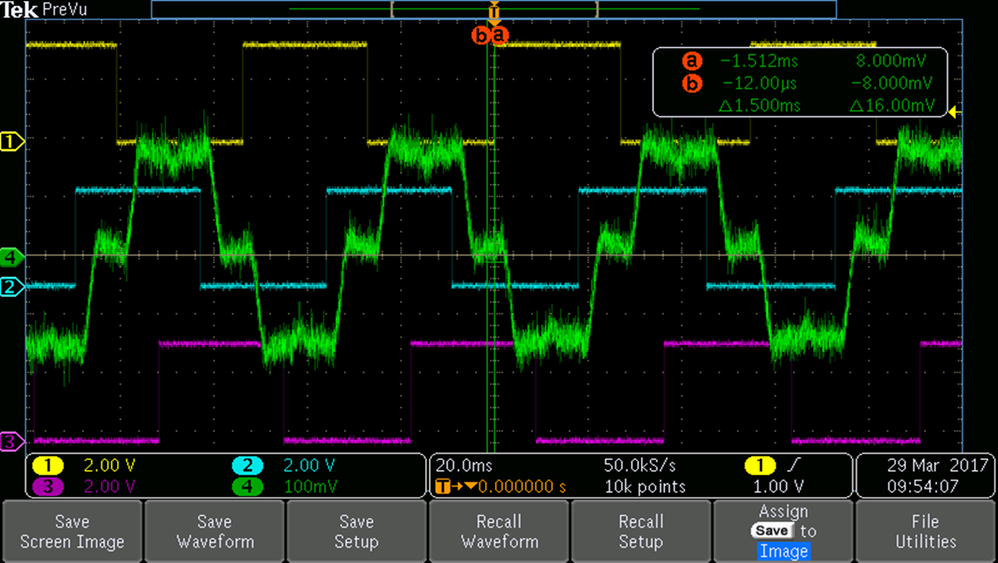

When measuring b-emf on UVW terminals I get
UVW correspond to channels 1-3 respectively.

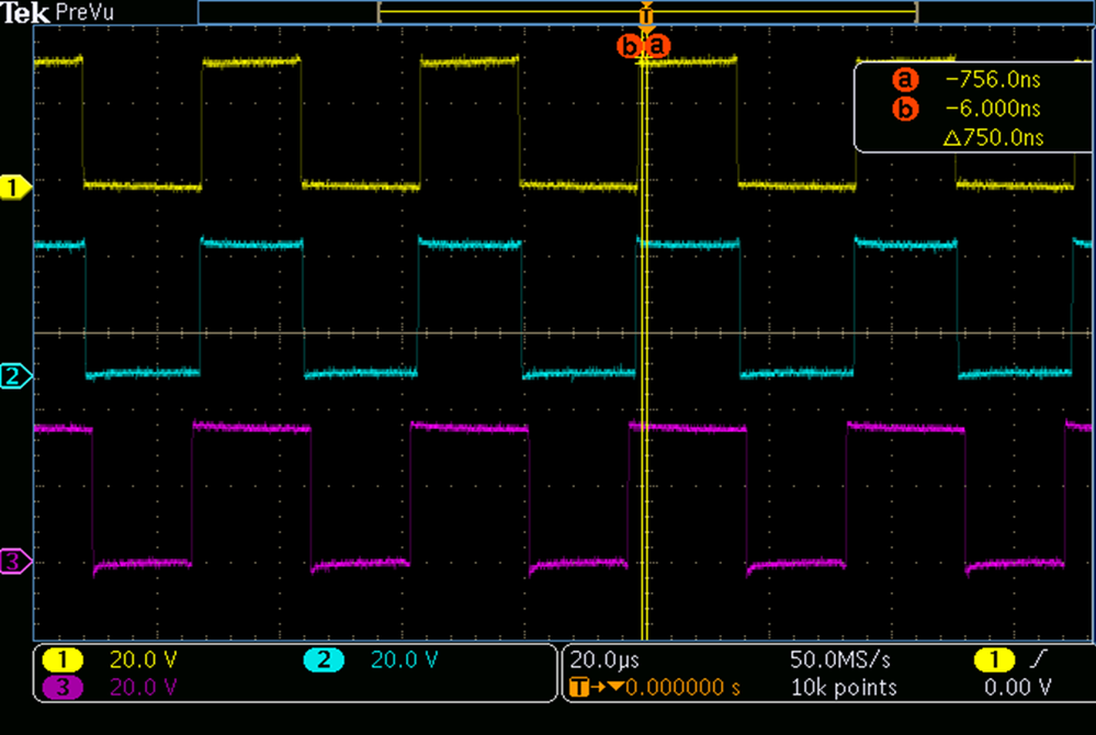

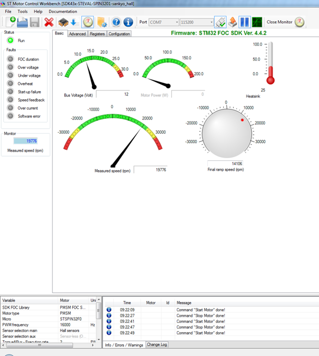

When trying to speed ramp to 15,000 in 15,000 ms I get the following UVW drives:
Motor starts spining for approx. 10s and then stops.
MC Workbench displays the flowing data after motor is stopped:
My SystemDriveParams folder & MC Workbench project is attached as a .zip file.

In your configuration file the PWM frequency is set to 16k and the execution rate is 2, as a consequence the 'bandwidth' of the FOC algorithm is 16k/2 --> 8 kHz. Not so fast.
Moreover you are using a motor with low inductance value, so and high PWM frequency is recommended in order to keep the current under control.
Please, try the attached setup with fPWM = 24k.
