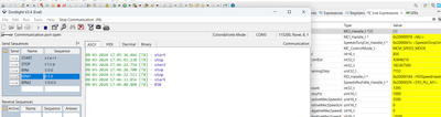

I am doing the project to control linear motor, For that I am using UART to send start and stop command to start and stop motor, as like this i sending different rpm value from 100 to 3000 randomly to change the ramp of the motor.
The problem that i am facing is for 3 digit number RPM i am getting output, but when is comes to 4 digit value i am not getting proper putput,
For example:
For 1000 RPM, I am getting 100 RPM as out put
  • Baud Rate: 115200 bps
  • Data Bits: 8
  • Parity: None
  • Stop Bits: 1

You've shown that "start" is received - but you haven't shown any numbers being received.

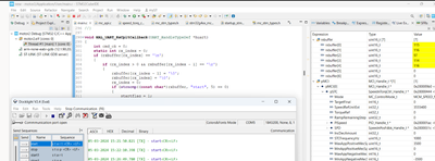

In 1st image 850 is received, in second image i sent 1000 it received 100
You still haven't addressed the fundamental flaw that your buffer seems to be uint16_t when it should be char.

In your screenshot, the Docklight is obscuring important detail of the debug output - so we can't see what's going on.

So you need to look into what's going wrong.
Send one character at a time, and follow-through step-by-step how that gets handled - to see where the handling goes wrong.
With the above-mentioned issues, it's not surprising that things go wrong ...
You're terminating things before the last digit comes in.
> if (rxbuffer[0] != '\0' && *endptr == '\0' && rpmValue >= 100 && rpmValue <= 3000)
Imagine that you've received 3 digits "100". Code gets to this line, it passes (since rpmValue >= 100), so you terminate things and set the speed to 100.
