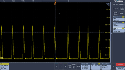

I am developing a custom board with the STSPIN32G4 microcontroller.
I would like to have more information about the integrated buck converter, as the documentation lacks details.
What is the maximum allowed peak current?
Output curent 12V :

The data-sheet DS1360 Rev 2 has IOC,Buck Buck Converter overcurrent threshold with a typical value of 1.2 A.
I'm not sure if you have seen this and you're asking for more information.
