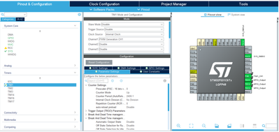

    I don't think I understand. From the documentation (namely the main document for STSPIN32F0A) I read, that TIM1 is primarily meant to produce PWM signal to control the MOSFETs. I am not sure what you mean by tampering with the timer. I also do not know what you mean by 'WB'.
    The documentation (RM0091) mentions nothing about 'secure mode', I also do not believe deadtime should be necessary, since I am only using one channel of the timer TIM1.
    I tried to attach the cubeMX .ioc file to provide some insight into my plight, but there is some issue with the file extension not matching the contents of the file, so I can only attach a screenshot of the pinout settings.
    Thank you for your help,
    Martin K. (aka Kalamar1)
    UPDATE: I've no idea what is different in comparison to my other attempts, but now the GPIO outputs are somewhat working. By 'somewhat' I mean, that when I turn on low-side transistors of the inverter, the associated phase is grounded, as expected. But when I turn on (open) the transistors in the upper stage of the inverter, its' associated phase is at 5.65V for some reason. This occurs regardless of the duty-cycle of the PWM, occurs even when I open the upper-stage transistor with GPIO instead of PWM (so that should be equivalent to DC of 100%, I believe).
    Again, I am left to guess at the reason why exactly that voltage is measurable on the phase, when the supplied voltage is 20V. I will try to update this thread for as long as my resolve to solve this lasts.
