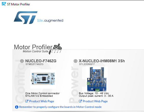

I am using the NUCLEO-F746ZG and X-NUCLEO-IHM08M1 3Sh configuration and try to run the motor Profiler. However, the programming seems to run properly, the connection to the board does not seems to work. I got the warning : The FW embeeded on control board is correct, but the control board communication is still missing.

in the Motor Profiler tool the configuration for X-NUCLEO-IHM08M1 board is available if used only with NUCLEO-F303RE or NUCLEO-F302R8.
If you use a different control board - NUCLEO-F746ZG - you cannot correctly drive the Power board.

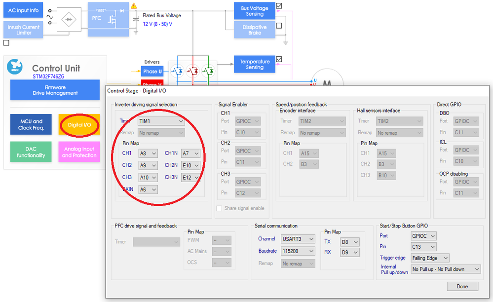

In the Workbench, did you create a new project with these two boards?
Did you use the ST Zio connectors to connect the boards?
In this case I suggest to check the proper mapping of Inverter driving signal (Digital I/O windows, TIM1 Pin Map):

That's a shame that I bought this board as it is listed in the compatible list of the motor profiler (as in the picture below).
In the Motor workbench, it appears that the default pin map is not right as you said. The filter on the Hall sensor on the X-NUCLEO-IHM08M1 is not working properly. The pull up resistor is not on the right side of the filtering. We finally manage to have the motor spinning, not very smoothly for now. And the soft filtering was not sufficient as it appears.

you are right, in my previous tests I was using an old version of Motor Profiler (5.4.3) where the board NUCLEO-F746ZG was not yet present.
Did you properly configure the boards in Motor Control mode?
You can find the configuration procedure step-by-step clicking on the "info" message below the boards.
Referring to Motor workbench tests I suggested to check the pin mapping according to your connection between the boards.
Are you using ST Zio Connectors or Morpho Connectors?
Depending on the connection the timer signals (TIM1) must be properly assigned.
