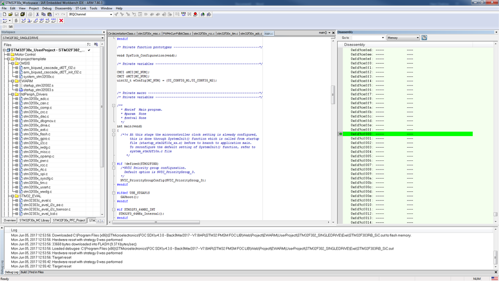

This compiled fine and uploaded but when running it always crashes and hangs. I'm not sure how it got to this location or what it is. An interrupt vector or ?:

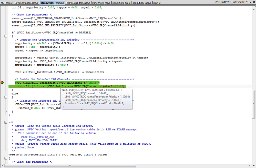

To debug, I stepped through the program until it hanged and I traced the crash point to the ''MCboot(oMCI,oMCT);'' function in main.c. So I assume something in the initialization is breaking down. Further stepping revealed that it seems to crash at the point of enabling IRQ channel 0x18 which I believe is TIM8_BRK_IRQn. If I try to step any further through the C code, it'll hang at this point. If I step through the disassembled code, it seems to get through this function but will then still hang if I let it free run after this.

Out of desperation, I tried to recompile using the STM32303C-EVAL_SINGLEDRIVE as this seemed to work for me initially. I changed the project configuration as required (eg. selecting correct device, making sure correct MC library is used etc). After compiling I loaded it into my hardware and BAM it worked!!
Strange - I set it up the same way as for the other F302 user project.
I started investigating. I looked at map files from both projects and noticed that the code was not exactly the same (as one would have expected). One of the functions compiled with a different size:
I investigated further and compared the project options, one by one. I noticed that one defined symbol was missing in the STM32F302_SINGLE_DRIVE project (eg. the one that was not working). ''CCMRAM'' was missing from the defined symbols list in project options. After adding this to the project that was crashing on me, it started to work. Comparing the map files now revealed exactly the same output from both projects.
Not sure exactly how not defining this symbol created the bad code so would love to hear someones though on this.
