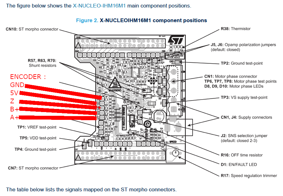

I would consider, if it wouldn't be so unstable. This might sound stupid but maybe the pins I have chosen on the IHM16M1 are wrong? If there would be some kind of tutorial for interfacing that thing (ihm16m1) with encoders or halls it would make it a lot easier as a beginner kit to be honest. Is there a chance that ANYONE could post a picture of a quadrature encoder interfaced with the expansion board and showing which encoder parameters are chosen in the motor control workbench?

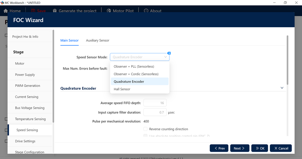

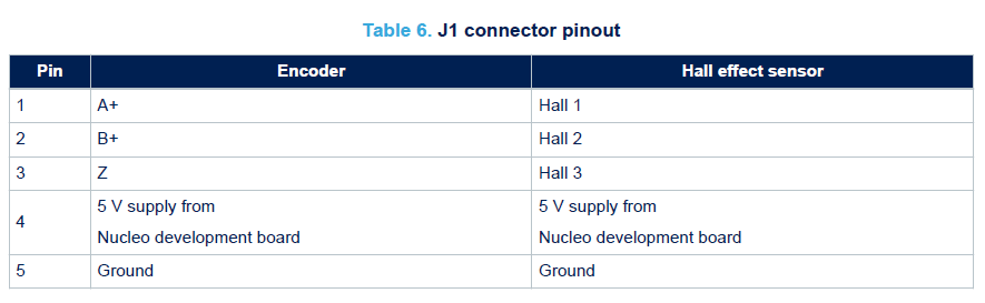

You will find attached a few pictures that (I hope) will help you understand a bit better how to enable the encoder via Workbench, and how to plug the encoder to the right pins of the IHM16 powerboard. The two last screenshots come from the IHM16 User Manual that can be found here pages 5 and 9.
How to enable Encoder mode via Workbench. Current sensing does not need to be changed.
The location of the 5 pins used for Encoder (and Hall Sensors) on IHM16M1.
Table of what should be plugged to each pin. Keep in mind that the order is important.

Thanks for these pictures! I have it exactly like that, so the issues might lay here: Either my motor parameters are not good enough or the encoder parameters are wrong or both. I guess I have to keep trying...
