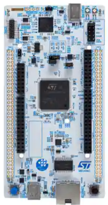

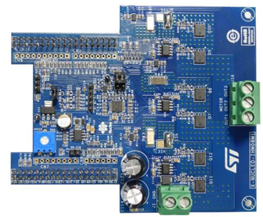

Does anyone know how to connect X-NUCLEO-IHM08M1 with NUCLEO-H563ZI?
I would to evaluate it with MC workbench 6.0.3. However. I am not sure how to connect it together.
It looks like I CAN'T plug it directly, because the slot and pins are not matched.
Solved! Go to Solution.
2024-08-15 01:07 AM
Hello yang2,
As you said, X-NUCLEO-IHM08M1 and NUCLEO-H563ZI can't directly be plugged together, you need to solder pins on the CN11 and CN12 connectors of the NUCLEO-H563ZI to do so. H563ZI CN11 goes with IHM08 CN7, and H563ZI CN12 goes with IHM08 CN10. Be careful to keep the pins in the right order (Number 1 pin on number 1...) The first two pin numbers are written next to their respective connector for each board.
