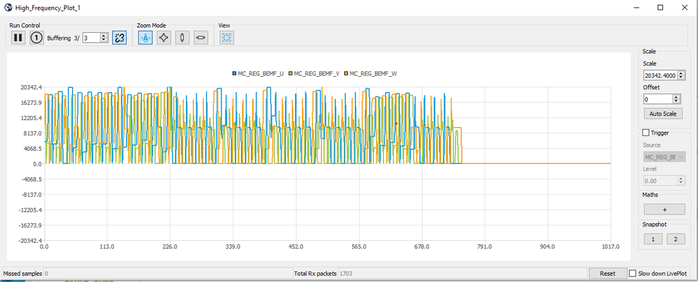

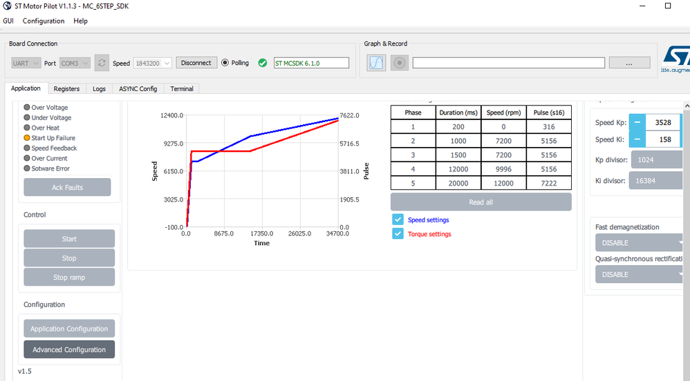

I built a 6step controller of a hi-revving, low inductance/resistance motor. It compiled in STM32CubeIDE and is pushed to the board.
I started the motor pilot and successfully connected to the board.
Made a couple of updates to the input a table of ramp up values - see image. Then monitor bemf (on the graph) and start the motor. It runs for several seconds before indicating "start-up failure"
Is there some documentation about how to tune the app and motor? 0693W00000Y75R7QAJ.png

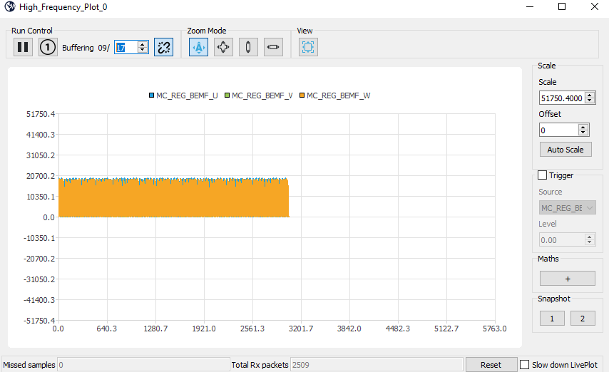

Also how do I manipulate the graphs? I notice if I use more buffers I can capture more details but can not zoom it.
