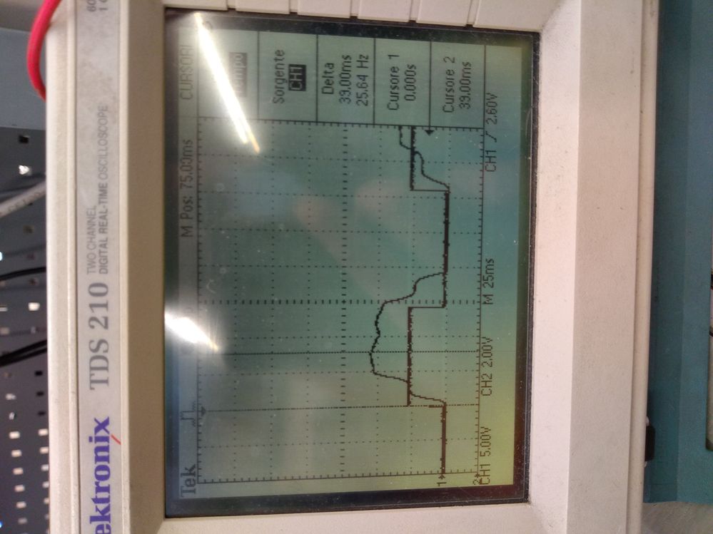

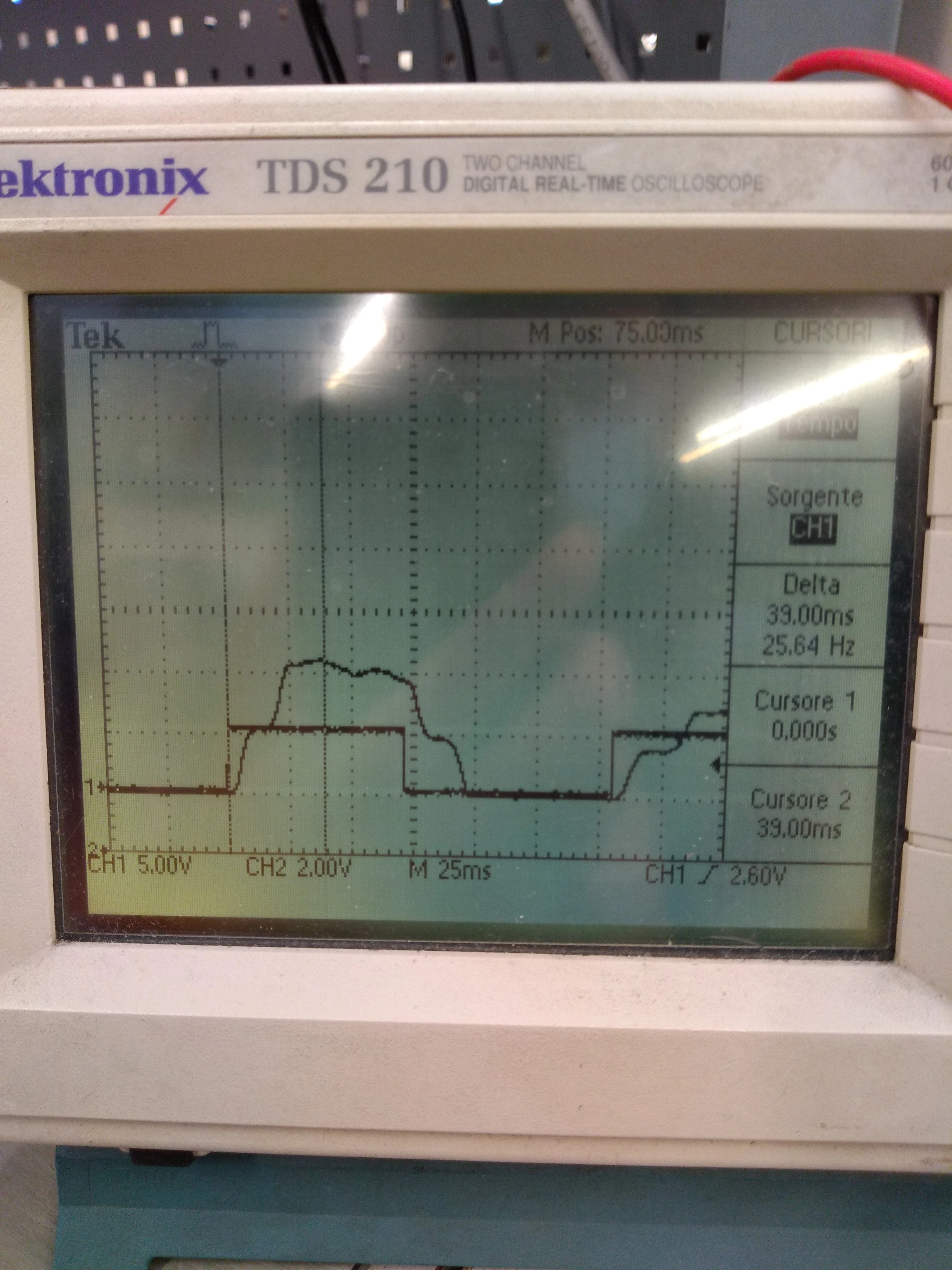

Is this somehow meaningful? Showing U and U hall sensor0693W000005BcmUQAS.jpg

I could also confirm that the Hall sensor states change every 1/3 of the current hall period, then the physical displacement should be 60°!

I’m not sure I got this last sentence: if there is a change each 1/3 of a period, then I expect a 120° displacement.

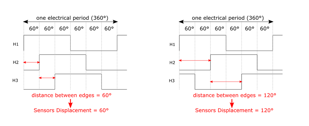

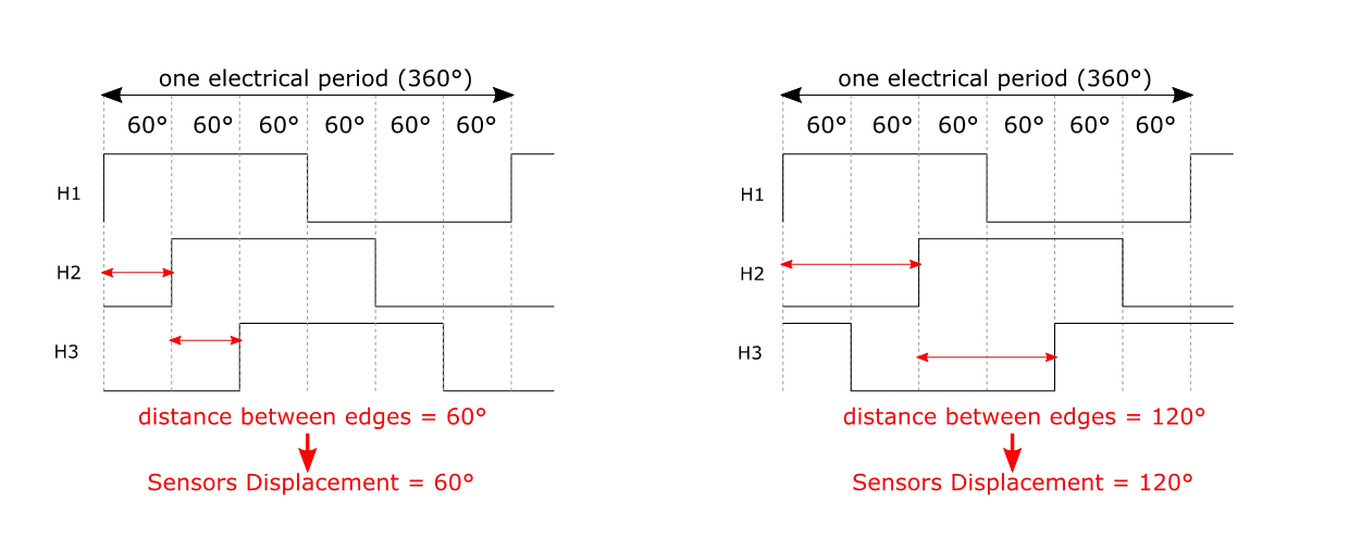

To make it more clear, I made a diagram about the digital Hall sensors:
0693W000005BsQ0QAK.pngAs you can see the sequence of the Hall sensors is always divided in “slices�? of 60° each.
But it is the phase between signal edges that makes the difference.
The combination the sensors’ digital levels is different each 60° in both cases.
It’s enough to measure two Hall sensors and see which is the displacement about your motor.
Then select the correct configuration in the workbench. Let me know the result !
As far as I know, a 30° displacement in the Hall sensor is not used because it cannot cover the entire range of the electrical angle.
For this reason the MCSDK supports 60° and 120° displacements only.
