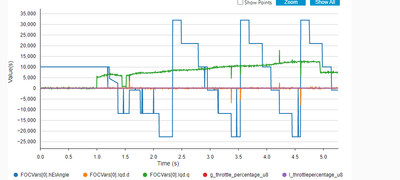

That is a big relief for me, i have not yet tested but hopefully there are no other serious bugs in the code and it will work fine. I have generated code from 6.2.0 and made modifications only to hall speed feedback code.
With the update of this code i do not get the Hall error but the start up is not smooth, it takes time before it starts and goes to normal speed in the vehicle in the loading conditions.
I really need some solution for this. The vehicle goes in kinds of steps before it picks up.

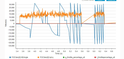

After flashing this software i am also seeing some kind of distortion in waveform in between or small kind of jerks
SRedd.5
Senior III

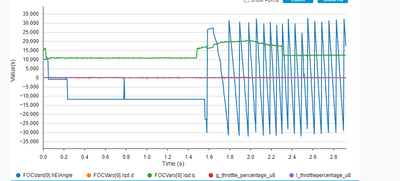

The hall fault still happens once in a while when using the work bench 6.20 but not as frequently as before from the previous work bench software's. This is observed in vehicle trails. Any other code updates to be done?
SRedd.5
Senior III
I think the mistake is from my end where the hall signals are going to hall state7 which is invalid, something to do with hardware. Regarding the initial slow ramp i increased the Kp and it starts little bit smooth. Thank you very much support.
This issue keeps happening where the vehicle goes in steps and jerks observed before it smoothens. Any support on this please.
