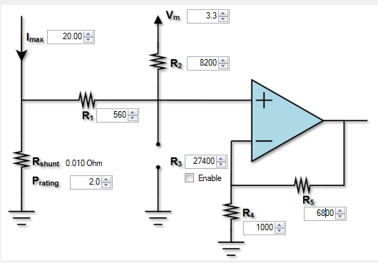

Step2 MCWB configuration:
When you create the project selecting the STEVAL-SPIN3202 as target board, most of the parameters are already set, but you should verify the following:
  • In the current sensing configuration, the opamp configuration should be the following:
  • Verify the FOC frequency is less or equal to 13 kHz. FOC frequency is PWM freq. divided by the execution rate (drive management --> drive settings)
  • The UART baudrate is 9600 (digital I/O)
