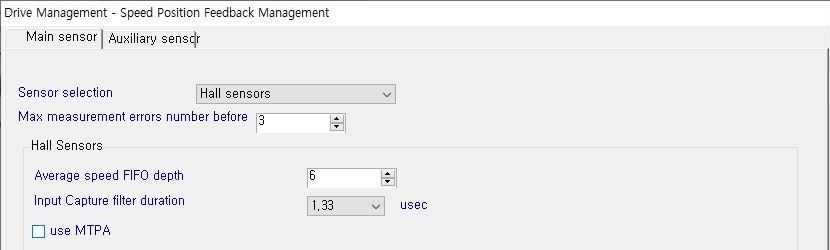

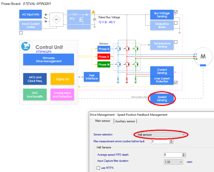

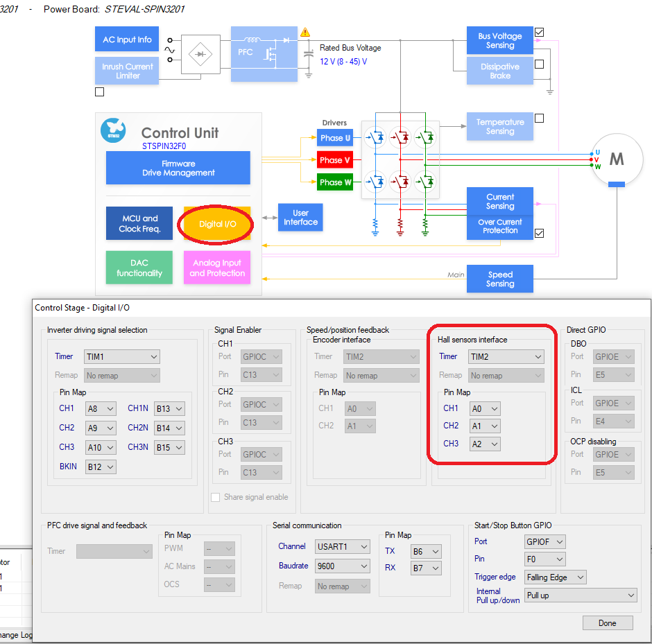

Hi @LYS​,
yes it is possible to use the STEVAL-SPIN3201 with Hall sensors for the position speed feedback.
You have to set the correct Sensor selection in the “Speed Sensing�? window:
0693W00000AMbpyQAD.pngand then in the "Digital I/O" → Hall sensor interface set the proper Pin Map:
0693W00000AMbtbQAD.pngFor more details I suggest to refer to the dedicated user manual UM2168 Using STM32 motor control workbench with STSPIN32F0 and STSPIN32F0A

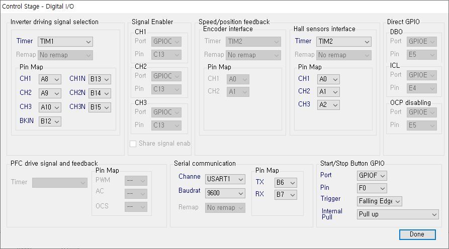

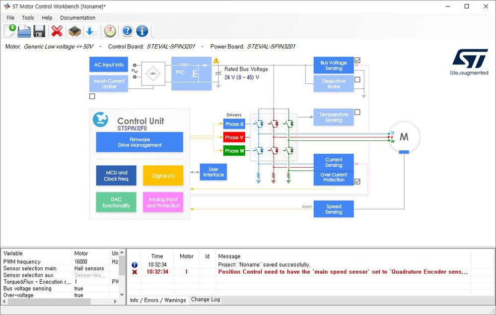

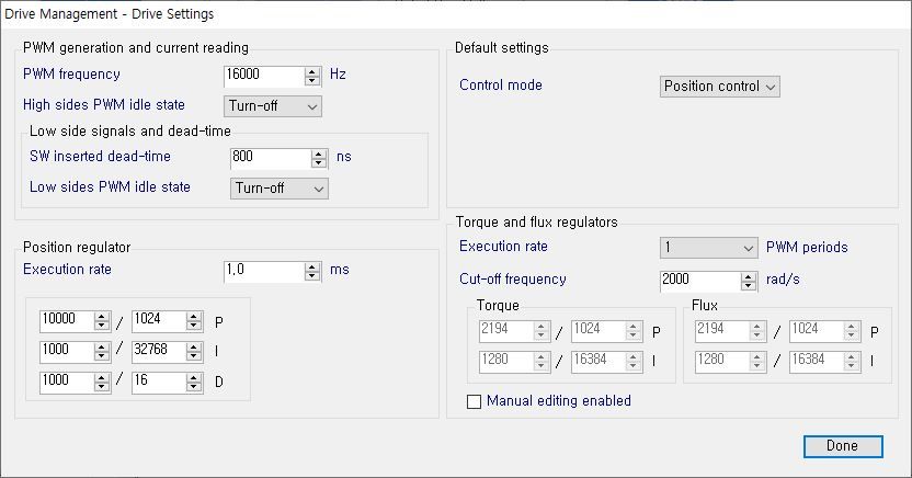

Hi, Cristiana SCARAMEL
Thank you for the reply.
Your Information is good for me but there is one problem.
Here is My setting
but an Error message is displayed.
" Position Control need to have the 'main speed sensor' set to 'Quadrature Encoder sensor' "
Is there more setting am I have to do?

Hi @LYS​,
the Workbench is right :grinning_face_with_sweat:
I have describe the setting for the "Speed feedback" with Hall sensors (I edited the previous post to avoid misunderstanding).
The answer is: you can use the Position Control Mode only with Quadrature Encoder sensor.
You cannot use the Hall sensors due to low positioning resolution.
