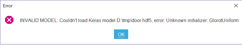

I have a same problem. I think maybe CubeMX/Artificial Inteligence is not compatible to Tensorflow 2.0 yet.
Windows 10
CubeMX 5.4
Artificial Inteligence 5.0.0
TensorFlow 2.0(Keras) model is here(very simple).

But I got a INVALID MODEL error when I try "Analyze" on CubeMX.
‎2020-01-05 6:38 PM
Please add following to each layer. It would fix the problem.
kernel_initializer='random_uniform'
for example :
model.add(tf.keras.layers.Dense(256, activation='relu',kernel_initializer='random_uniform'))
‎2020-01-05 7:03 PM
Analyze works!! thank you.
