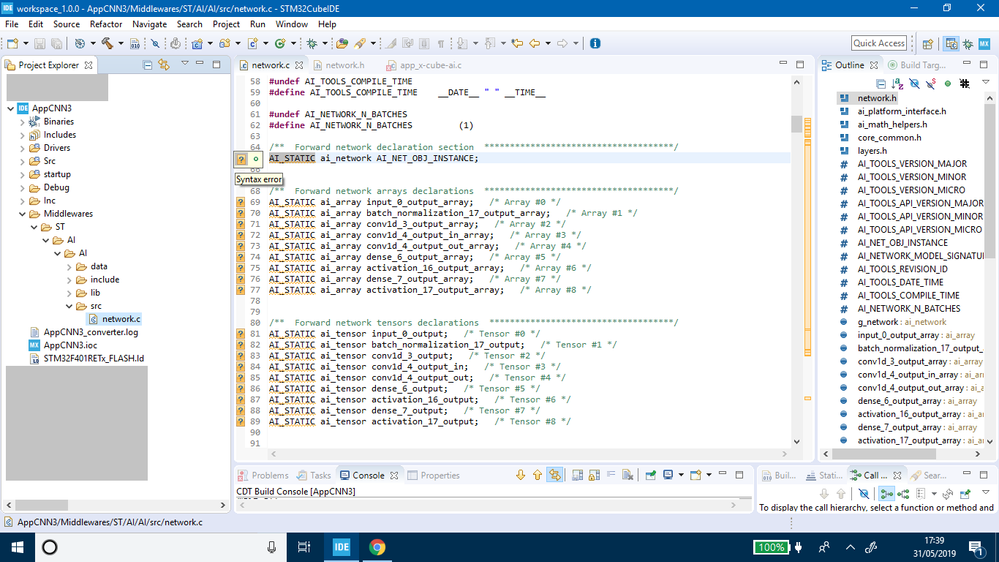

I've a problem with the generation of the code for the application template. Following the steps, i've generate a blank code, but there's a weird problem, maybe something about linker.
In fact looking in Middlewares/ST/AI/AI/src/network.c there are a lot of syntax errors, like if the variables defined in "network.h" wouldn't be considered, even with #include "network.h".
besides, calling a function that is defined in network.h, like ai_network_create for example, i get this error "Undefined reference to ai_network_create".

here some errors in network.c

‎2019-06-04 10:13 AM
i've solved
the problem was in the code generation spec
i had to select True studio as IDE, uncheck Generate under root and select copy only the necessary library files.
in this way i was able to load and run an application template on my board without linker problems.
instead for validation template generate under root must remain selected.
‎2019-06-03 1:10 AM
In the project properties can you verify that the include paths have been generated properly.
You should have something like
../Inc
../Middlewares/ST/AI/AI/include
../Middlewares/ST/AI/AI/data
then the regular HAL and CMSIS includes
Regards
