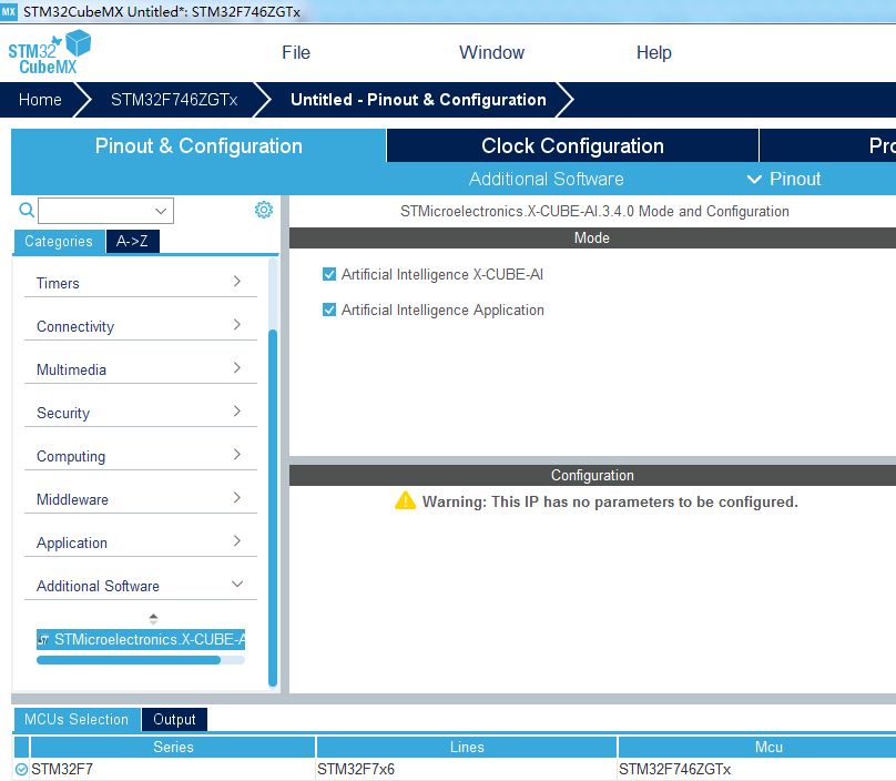

X-CUBE-AI.3.4.0 This IP has no parameters to be configured.
hi
My STM32cubeMX version is 5.2.0
X-CUBE-AI.3.4.0
But when I follow the steps, I find the information as follows:
So what should I do to make it OK?

    The X-Cube-AI STM32CubeMX plugin is not loaded in your environment.
    I recommend to uninstall the X-Cube-AI pack and reinstall it.
    If the installation is successful you should have this file in your installation: C:\Users\xxxx\STM32Cube\Repository\Packs\STMicroelectronics\X-CUBE-AI\3.4.0\CubeMX\plugins\ip\ai.3.4.0.jar
