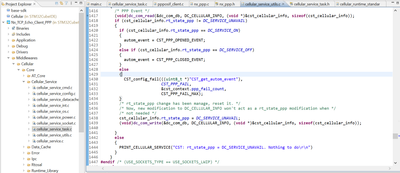

Not able to bring PPP connection using X-Cube-Cellular Nx_TCP_Echo_Client_PPP example.
srikanthpalvai
Application is restarting after MODEM_PDN_ACTIVATING_STATE - PDP_ACTIVATED_EVENT
the IP stack running STM32-side with LwIP.

//Application is restarting here.
Nx_TCP_Echo_Client application started.
Create IP instance...
Get IP Address...
@MJAC.1  Any suggestions please

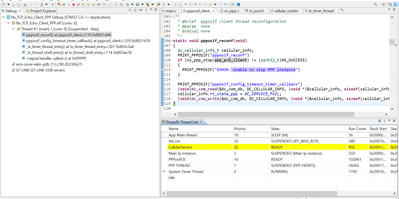

I have observed that it's failing here and then issuing the MODEM_REBOOT_STATE.

I am not sure why nx_ppp_stop is resulting 11, in the ppposif_reconf(ppposif_config_timeout_timer_callback)
Need some inputs here, I was able to get the CONNECT from the SIM Modem
PPPosif:ppposif_client_config
IPC:IPC select 0x20019200
PPPosif:PPP is now created
PPPosif:ppposif_reconf
PPPosif:ERROR: nx_ppp_stop:11
PPPosif:ERROR: Unable to stop PPP instance
PPPosif:ppposif_config_timeout_timer_callback

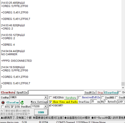

This looks like some communication issue between the STM32 and modem - not getting the expected response
Together with this error: "ATCore ERROR:DATA ongoing, can not send a command"
Sorry I don't have this module so cannot loop deeper into it.

It's an issue with the modem, Tried with another modem now able to establish the connection.
PPPosif: our_ipaddr = xx.xx.xxx.174
PPPosif: his_ipaddr = 0.0.0.0
PPPosif: netmask = 255.255.255.255
PPPosif:
STM32 IP Address: xx.xx.xxx.174
DNS Server address: 8.8.8.8
Thanks for the support :)
