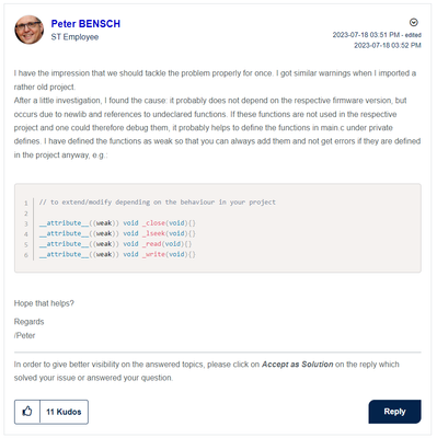

I have the same problem as original poster. I believe that the suggestion to use an updated IDE is not a solution.
I am using STM32cubeIDE and go to select "Import existing projects into workspace"
select relevant example from the x-cube folder .
it loads up in the IDE and the relevant files are all seen in the IDE. It compiles all the project files ok, then complains about _close_r, _lseek_r, _read_r, and _write_r when creating the .elf
I am already running STM32cube ide v1.14.1 (though not a fresh install- looks like I upgraded from 1.13.1 if that makes any difference?)
this is a problem for the nucleo G431RB project (which I can confirm does not work if you try to debug/run it after compiling, as the warnings would suggest)
but I tested a few other projects the same way (but without a target to run them on) also seems to be a problem for the G474RE project and the C031C6 projects (same error on compiling)

Hello @Julian1 ,
I think you're talking about Build warning, not build error. Could you please share a screenshot?
The problem that is causing the failed build was described in CDT (https://github.com/eclipse-cdt/cdt/commit/1b2472faff2028f0323ad5c5eb85565f81b89053).
For more information about these warnings and how fixed them, I advise you to check this post and precisely @Peter BENSCH answer.
I hope this help you.
Kaouthar
Thanks for your reply .
Yes I have the same error output that Robin mentioned in the original post.
Can confirm that answer makes the warning go away.
Also, after being a bit more patient with testing the demo app, it *does* show the 3 second flash on completion... just much longer after the startup than I was expecting.
