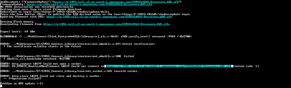

I'm using x-cube aws sdk with P-L496G-CELLONE development board
SDK version is 1.4.0 having aws version 3.0.1
I can successful connect with the my MQTT aws server
Now the problem is, when i try to do OTA then, out of 5 attempts, 4 attempts fails
Every time I'm getting same errors of handshaking(-0x2700)
I have all default settings in mbedtls_config.h
I'm unable to set the debug_level to 4 due to the limitations of the SRAM in mbedTLS
Here is the error logs
All suggestions and comments welcome
Thanks

In order to diagnose the "​The certificate validity starts in the future" error, the first thing is to verify that the date of the Real Time Clock of the MCU is initialized properly.
In the demo application, this init is performed by HAL_RTC_SetDate(). The RTC is then used by mbedTLS through the time() function.
The second point to check is the validity period of the server certificate, for instance thanks to a web browser (https://support.mozilla.org/en-US/kb/secure-website-certificate).
- grd

issue has been resolve
That is might be the selection of wrong editor to open the AWS credentials
Notped ++ helps a lot
