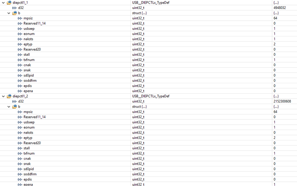

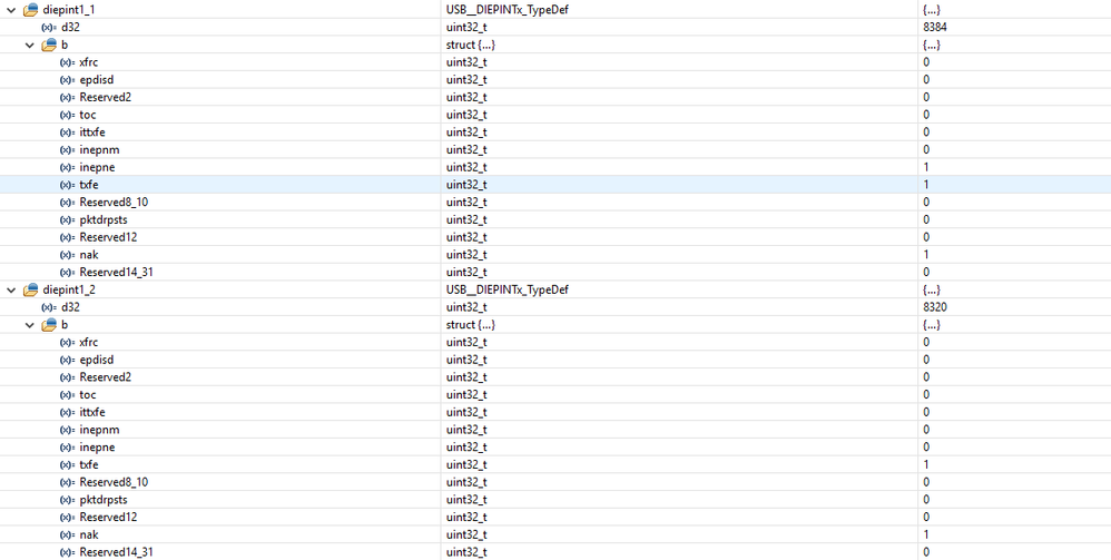

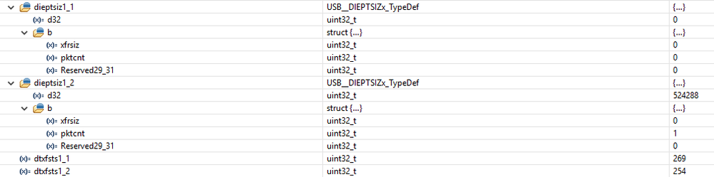

waldi
sent[siz1cnt].diepint1_1.d32 = USB.INEP_REGS[1]->DIEPINT;
sent[siz1cnt].diepctl1_1.d32 = USB.INEP_REGS[1]->DIEPCTL;
sent[siz1cnt].dieptsiz1_1.d32 = USB.INEP_REGS[1]->DIEPTSIZ;
sent[siz1cnt].dtxfsts1_1 = USB.INEP_REGS[1]->DTXFSTS;
dieptsiz1.d32 = USB.INEP_REGS[1]->DIEPTSIZ;
dieptsiz1.b.xfrsiz = 60;
dieptsiz1.b.pktcnt = 1;
USB.INEP_REGS[1]->DIEPTSIZ = dieptsiz1.d32;
USB.INEP_REGS[1]->DIEPCTL |= DIEPCTLx_EPENA|DIEPCTLx_CNAK;
for (uint32_t i = 0; i < 15; i++){
	*(USB).DFIFO[1]=siz1cnt;//USB_buffer[i];
sent[siz1cnt].diepint1_2.d32 = USB.INEP_REGS[1]->DIEPINT;
sent[siz1cnt].diepctl1_2.d32 = USB.INEP_REGS[1]->DIEPCTL;
sent[siz1cnt].dieptsiz1_2.d32 = USB.INEP_REGS[1]->DIEPTSIZ;
sent[siz1cnt].dtxfsts1_2 = USB.INEP_REGS[1]->DTXFSTS;
DIEPINT before and after:0690X000009Zcj7QAC.png
DIEPCTL before and after:
DIEPTSIZ & DTXFSTS before and after:

waldi
Register content before and after failed response.
waclawek.jan
I can't see anything irregular, sorry.
I know this is a hard question to answer, but does the STALL response start only after the last transfer has been started? I mean, couldn't STALL result from something else, that happened already before the routine starting the last transfer (and then that the last transfer has not completed is only a consequence of this)?

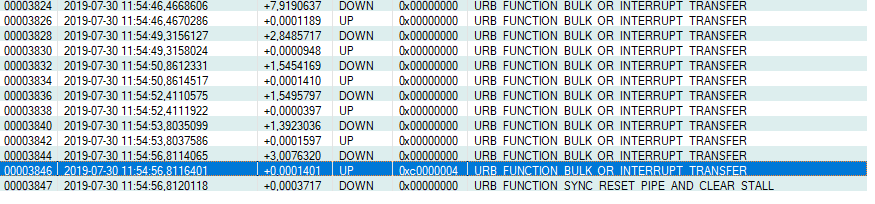

waldi
  1. Every transfer is initiated manually by sending 5 characters to MCU. Before the last transfer I don't see any STALL or something irregular.
  2. I'm not 100% sure it is a real STALL, because this information I got only from Device Monitoring Studio. The flag in DIEPCTL doesn't show STALL. I thought it could also be some automatic feature like:
"Bit 2 NZLSOHSK: Non-zero-length status OUT handshake
The application can use this field to select the handshake the core sends on receiving a
nonzero-length data packet during the OUT transaction of a control transfer’s Status stage.
1: Send a STALL handshake on a nonzero-length status OUT transaction and do not send
the received OUT packet to the application.
0: Send the received OUT packet to the application (zero-length or nonzero-length) and send a handshake based on the NAK and STALL bits for the endpoint in the Device endpoint control register."
Thank you for USB beagle hint. I thought I could avoid it)

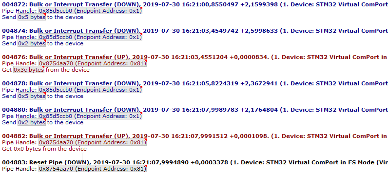

I have separated the transfer init, which is loaded if I receive 5 chars:
and transfer load, which is stats if I receive 2 chars:
if ((received_byte_count ==2)){
	received_byte_count=0;
The behavior is the same after ca. 10 successful transmissions. And: the STALL is detected after transfer load:
