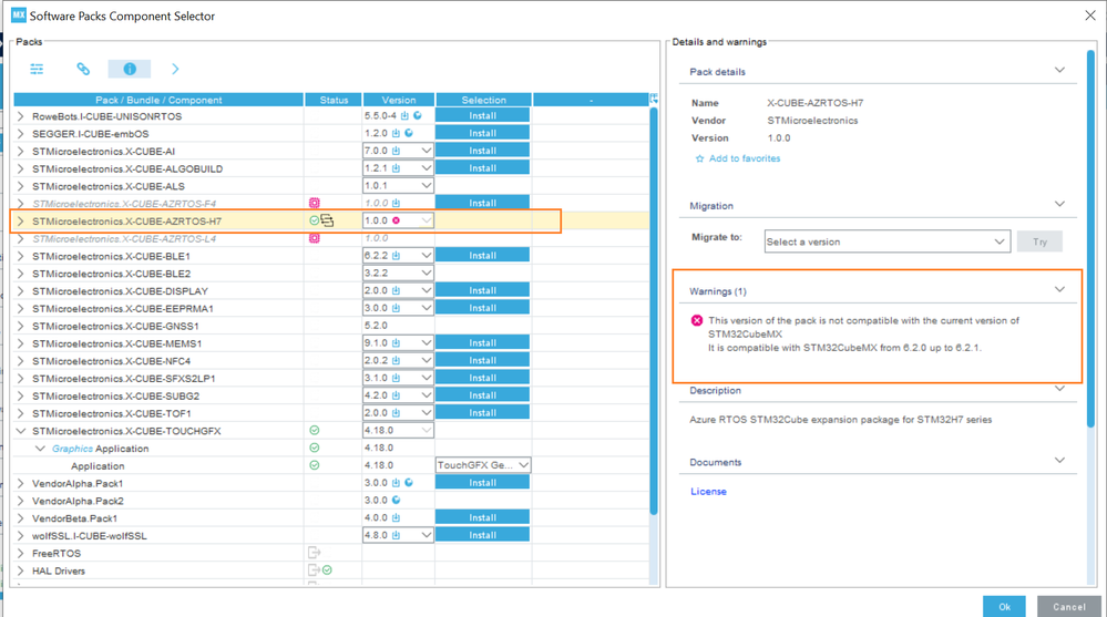

0693W00000GX6FDQA1.pngThis project is using an old version of X-CUBE-AZRTOS-H7 (1.0.0) which is compatible with the old STM32CubeMX version (6.2.1).

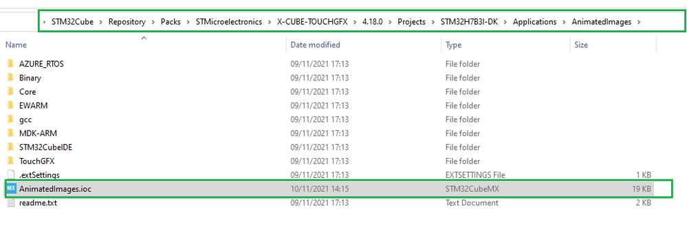

You have the STM32H7B3I-DK example available from the X-CUBE-TOUCHGFX pack
You will find it inside the Projects folder located in the installation folder for STM32CubeMX packs(inside your C:\<USER>\STM32Cube\Packs\STMicroelectronics/X-CUBE-TOUCHGFX\<Version_id>\Projects\...)
Please note that that project was build based on AZRTOS-H7-V1.0.0 which will require you to do few steps in order to make it running again with AZRTOS-H7-2.0.0.
