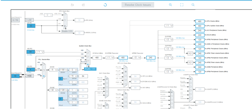

In order to reach the best performances with SYSCLK at 480MHz and use the USB OTG FS with the external clock source HSE you should use the PLL1Q for the UsbClockSelection.
To avoid any issues you should use STM32CubeMX for the clock and peripherals initialization.

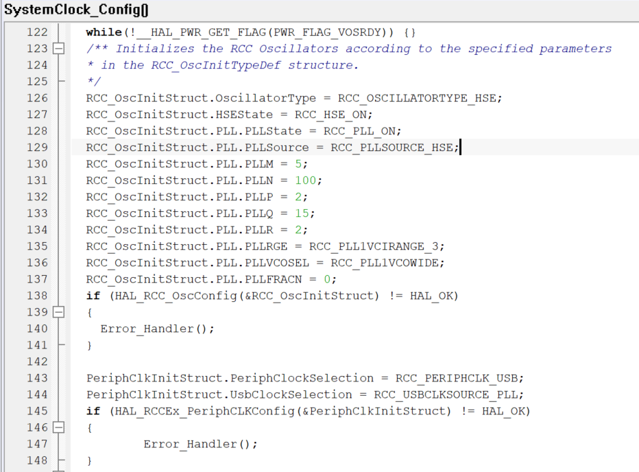

Exemple of systemClock_Config with the external clock as the source clock for the SYSCLK and USB on PLL1 at 64Mhz. Can you try this one ?

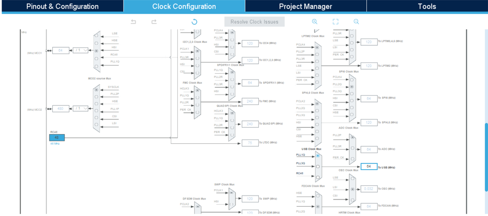

When you switch the clock source for your USB (not connected to HSI48) which PLL do you use ? Because the USB can be clocked only by the HSI48, PLL1 and PLL3, and both PLLs are connected to your HSE oscillator (if configured).
Once you've identified the PLL, can you send me its configuration ? (Coefficients PLLM, PLLN, PLLP, PLLR and PLLQ)

I apologized for the delayed response, I tried another time the configuration I used : PLL1 for the USBclock and external clock as the clock source for SYSCLK. Here is the SystemClock_Config :
void SystemClock_Config(void)
/** Supply configuration update enable
HAL_PWREx_ConfigSupply(PWR_LDO_SUPPLY);
__HAL_PWR_VOLTAGESCALING_CONFIG(PWR_REGULATOR_VOLTAGE_SCALE0);
while(!__HAL_PWR_GET_FLAG(PWR_FLAG_VOSRDY)) {}
/** Macro to configure the PLL clock source
__HAL_RCC_PLL_PLLSOURCE_CONFIG(RCC_PLLSOURCE_HSE);
RCC_OscInitStruct.OscillatorType = RCC_OSCILLATORTYPE_HSI|RCC_OSCILLATORTYPE_HSE;
RCC_OscInitStruct.HSEState = RCC_HSE_ON;
RCC_OscInitStruct.HSIState = RCC_HSI_DIV2;
RCC_OscInitStruct.PLL.PLLSource = RCC_PLLSOURCE_HSE;
RCC_OscInitStruct.PLL.PLLM = 5;
RCC_OscInitStruct.PLL.PLLN = 100;
RCC_OscInitStruct.PLL.PLLP = 2;
RCC_OscInitStruct.PLL.PLLQ = 20;
RCC_OscInitStruct.PLL.PLLR = 2;
RCC_OscInitStruct.PLL.PLLRGE = RCC_PLL1VCIRANGE_3;
RCC_OscInitStruct.PLL.PLLVCOSEL = RCC_PLL1VCOWIDE;
RCC_OscInitStruct.PLL.PLLFRACN = 0;
Error_Handler();

PeriphClkInitStruct.UsbClockSelection = RCC_USBCLKSOURCE_PLL;
if (HAL_RCCEx_PeriphCLKConfig(&PeriphClkInitStruct) != HAL_OK)
Error_Handler();
