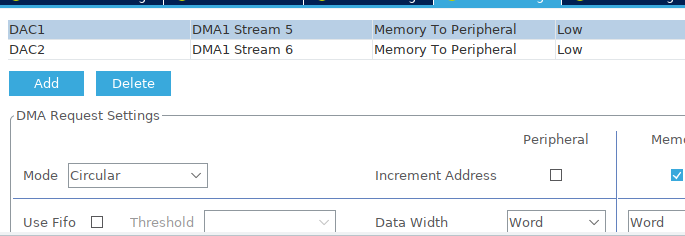

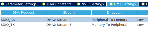

i read the ST instructions and looked in the EVAL Board example. There they used a audio jack via SPI but in want to play the file direct on DAC.
First to check if the SD Card works i write and read a file to it (works). Then I call the "play_sound" Funktion.
My problems to solve:
  1. Open the file don't work like the text file -> What's the problem
  2. How can I transfer the value of buffer one and two to the DAC. May be via DMA

    res=f_open(&myFile, "open_sound_mono.wav", FA_READ); // Don't work. SD Card is already mounted and TXT File write and read worked properly
     res=f_lseek(&myFile, f_size(&myFile));
     res=f_read (&myFile, buffer1, _MAX_SS, &BytesRead);
     res=f_read (&myFile, buffer2, _MAX_SS, &BytesRead);
      res=f_close(&myFile);

Okay File is loaded step by step to DAC but no proper sound, may the speed is wrong?
CPU Frq = 72MHz
static void MX_TIM6_Init(void) // Trigger for DAC DMA
