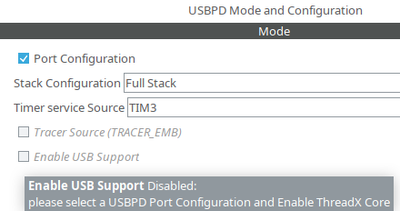

I have found out why there is no usbpd_usb_if.c/.h files generated because we need to activate "Enable USB Support" inside the USBPD configuration tab:
