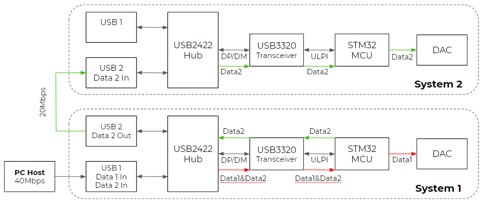

I'm designing an embedded system that connects to a PC for USB data and converts it to an analog signal.
This is an HS USB device with 2 USB ports which needs to process 4 channel 40Mbps data.
This device can work as a single system, but with some setup, I want to make the device send 2 channels of the data to the same device system connected through another USB port.
Even though there are 2 USB peripherals in STM32F7 series, only 1 is HS and the other is FS. So I can't use FS port due to slow speed.
Also, I can't connect 1 computer to 2 systems directly due to some limitation.
Can the system diagram below achievable?
I couldn't think of a better way to implement this idea.
Thanks in advance.
T J
Lead
I was suggesting that you take Usart1 over the the other processor.
getting your system to recognize the USBHUB is not trivial.
You'd probably shoe this in with a STM32MP1 , but not a STM32H or STM32F series processor.

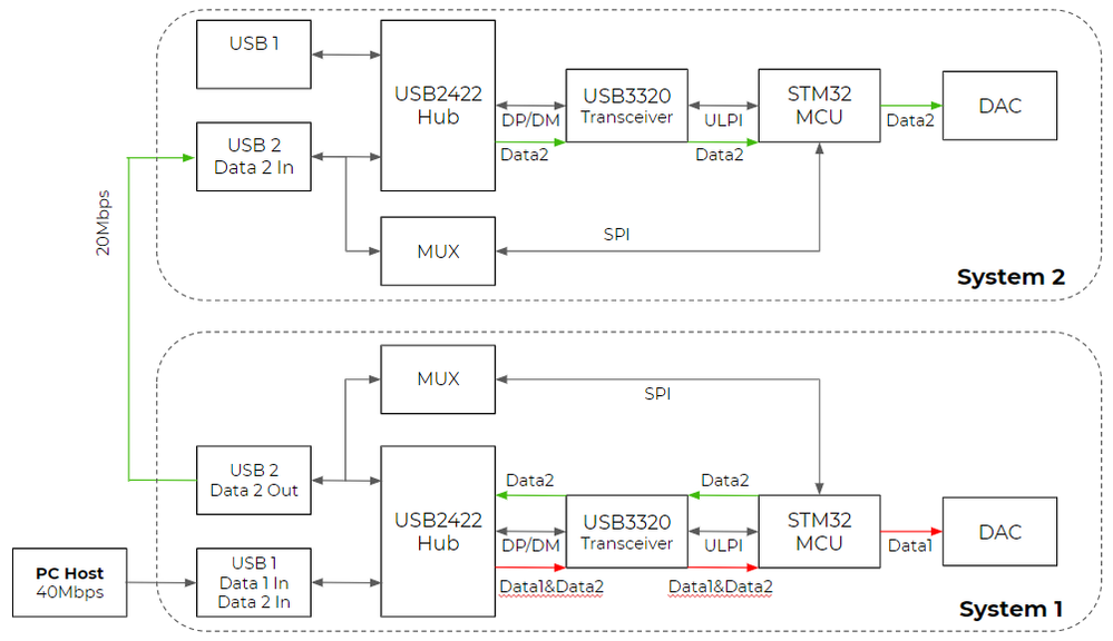

BHan.1
Is the below diagram what your are suggesting?
I think this is a good option. I will be using USB C port so pin number is not a problem.
If I not understanding you please let me know. Maybe you are saying data can be transferred using DP/DM pin without using MUX.
T J
Lead
